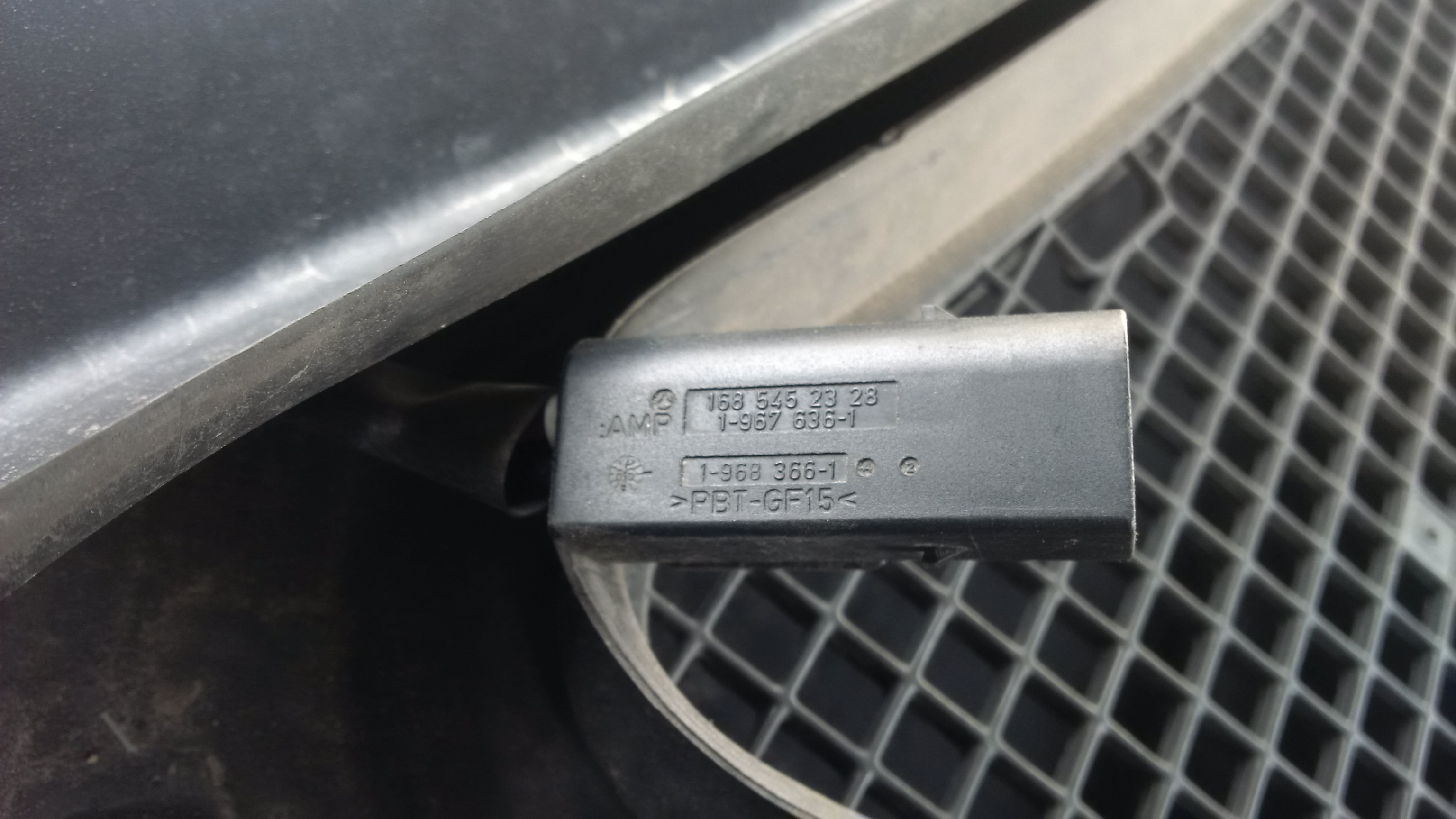

After taking a closer look at the wire, it's not a ground.
My totaled S500 has the same wire coming from the inside of the car but once out it has a plug that connects to nothing. So I called my local dealership and some guy told me that from the part number provided (168 545 23 28) that "plug" didn't belong in my car and it usually has to do with the fuel pump (but he's wrong since both my S500's had that part).
So i decided to get a second opinion, I called SilverStar Mercedes in Montreal (biggest MB dealership in Canada) and I've learned that this part has to do with an auxiliary blower found only on S65s (Both my cars are MY01, weren't S65 only introduced in 03?).
So on my car (S500), it shouldn't be connected to anything. But it is/was before burning! And it's not some "jobber" that played around with the car, because everything looks OEM (has the same "tape", goes in a big connection of other wires, etc.)
The wire has been now cut and tapped, and every thing in the car still works (played with every little gizmo and everything is still functional).
At first, i thought it had something to do with the parking sensors, but even after completely cutting the wires, the sensors still work.
So what the hell does this wire do? do you have it connected to something? Right now, the car is still being driven with that wire being cut and taped with electrical tape and twisted caps. But i'm still scared that it could burn again since one part of the wire is still "live" and for the next few days i have NO time to take it in and get it looked at. (i know it's stupid, but i need the car and have no time right now!)
Here's some pics of the plug i'm talking about (pictures are from the S500 with the plug connected to nothing, since the one that caught on fire completely melted)
Attached Thumbnails Help: Fire under the hood-img_20140429_110127.jpg   Help: Fire under the hood-img_20140428_140758.jpg

Hi there,
I had this intermittent "rattle" up front... which I sort of lived with and end last year I thought I would lube / service the whole windscreen wiper unit/mechanism. (Good idea to do - many little points / joints to lube!!!)
On removing the entire cast aluminium w'screen wiper unit (very easy to do) - I saw the rattle culprit!
Yes : the same connector had somehow got into the wiper assembly and the wipers in action at some point in time, physically "chopped" this connector off the wiring harness! Connector lying in the bottom area below the screen!!
Likewise, I also could not fathom out what / where / how this connector belonged!
If as stated this connector is for the aux blower unit - all is good and fine, my car doesn't have this aux blower.
Attached Thumbnails Help: Fire under the hood-20140625_082806-1-.jpg

I located the connection on my car. It attaches to the windshield. OEM windshield has a sun sensor and that sensor attaches to the windshield on my car. The new windshield already has the same connection if it is OEM. It seems as if when the windshield was replaces the wire was accidentally cut. That is why it is laying under wipers with no connection. The company id not reconnect the wire. I made the connection to the windshield and threw away the severed connection.
My car is a 2009 W216 CL600 same connections as the W221 S-class

It is the heating for the resting place of the wipers.
So the installer of your windshield replacement is probably to blame..

I'm no sure it is an option, it is connected on my base model.
On the fuse chart it is listed as Wiper recess heating, the fuse is f1, 40 A.
