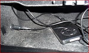

Bob, you are correct. My car does not have a tape deck. Truth be told, I never knew the plug was there until I was changing the filters under the glove box. Thought it was a screw until I realized it was for some type of connection. I decided to test it and realized it was live. Went to BestBuy, bought the cable you see and plugged in my IPOD. The IPOD works from the AUX menu in the Command unit.
Jason you might want to go into the "start here" section of the forum. There is a multitude of information on this subject and others related to the CD player/sound system.
This is how mine looks.
Attached Thumbnails Cheapest and easiest way to add aux cable to 2003 S500?-picture-aux-plug.jpg
