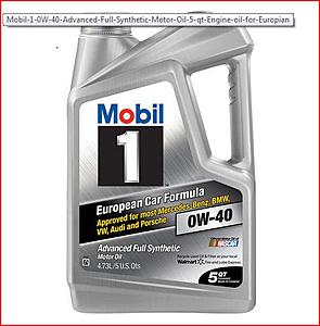

According to the factory approved service products the following oils are approved in MB Sheet 229.1/229.3 for the S Class gasoline engine:
1- Mobil 1 SuperSyn European Car Formula.......OW-40
2- Castrol Syntec...........5W-40
3- Quaker State Full Synthetic European Formula......5W-40
4- Pennzoil Synthetic European Formula.....5W-40
5- 76 Pure Synthetic Motor Oil.....5W-40
It is up to you but I would just buy the Mobil 1 0W-40 European formula which meets the MB specs. Buy the European Formula.
