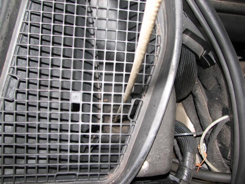

Water in the plastic reservoir under the passenger side windshield ?
If so You have water damage . Pull up the passenger carpet and dry out with hair dryers . Dry out the fuse box . Clear the drain at the bottom of that plastic reservoir with a long screwdriver or chopstick as shown . Do not start car you'll fry the electronics. If you have comprehensive auto insurance they should cover water damage

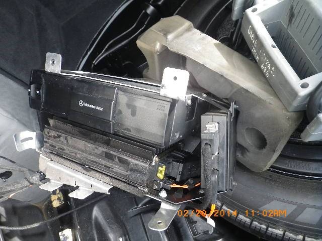

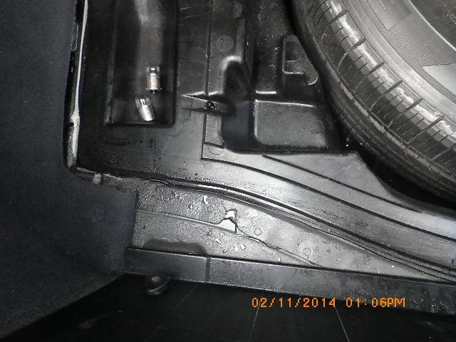

Or if you meant water in the trunk, you have water damage there . Again pull up all carpeting and dry out immediately
Mercedeslove1-744f6a98-7e65-4d59-8091-fcfa2f75e4da-569-0000005fda49fa30_zpsd4fb49ff.jpg
Mercedeslove1-7d705b4e-3d9d-4bbd-a346-f25faa7c56cd-5282-0000049b6a1c4ec9_zpsdfe1ed66.jpg[/QUOTE]
