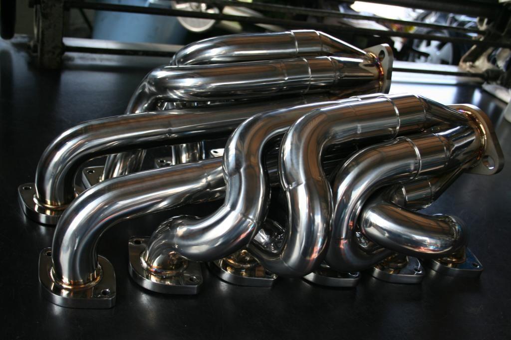

For reference , here are pictures of the actual headers from the F1 sounding S600:
Also, if people want to hear how different header arrangements affect sound , you can listen to the various types of exhaust that people have put on the Honda CBX: https://www.youtube.com/watch?v=vKUwixRfBf4
Wow, I never noticed how awful the warping/flange alignment is on the "f1 exhaust" before. That's horrible, lol.
They aren't , the pipes are just resting in the collector unwelded.

The second image (headers on the table) are a set of W220 headers i have from TG Sasaki. As nkautz1 says, they're just resting in the collector - the actual quality & workmanship is bonkers
