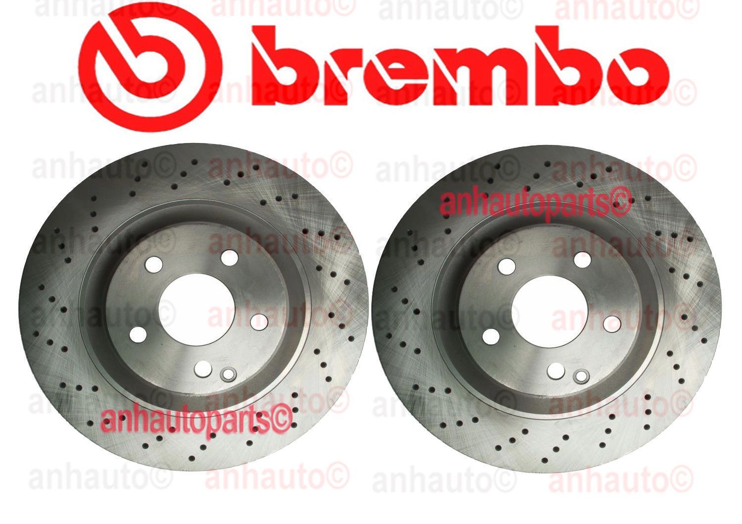

Nice read. Thanks again you guys. I'm gathering some info regarding brake parts replacements. I've seen the Zimmerman brakes and I have a question regarding that and good quality aftermarkets vs. OEM. Mind you, mine is 2001 S600 and not sure about the 03 and up models as to how different they are BUT I have seen some pictures of the OEM disc brakes and pictures of the Zimmerman or even the Brembo replacement. But is it me or is there some sort of gray coating on the OEM ones that don't exist on the aftermarket ones? I assume that gray-ish coating is really just on the surface and goes away? Is there a purpose behind them compared to not being on the aftermarket ones? Take for example:
Brembo
OEM:
Old Jun 22, 2016 | 03:10 PM

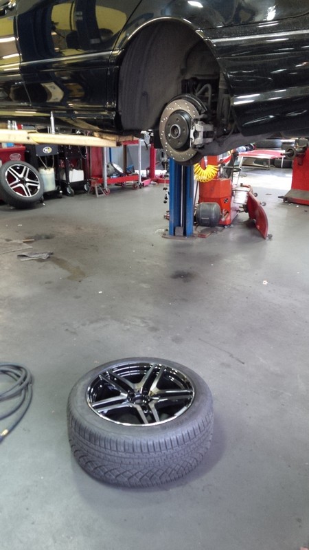

Just like you, I found it odd that only the fronts were drilled and the rears were solid on my 05 S500 4matic. So last summer I needed brakes for the rear and decided to go with Drilled StopTech Rotors and Oem Pads. Needless to say, I now have a matching front and rear rotors. Here is a pic of the rears
