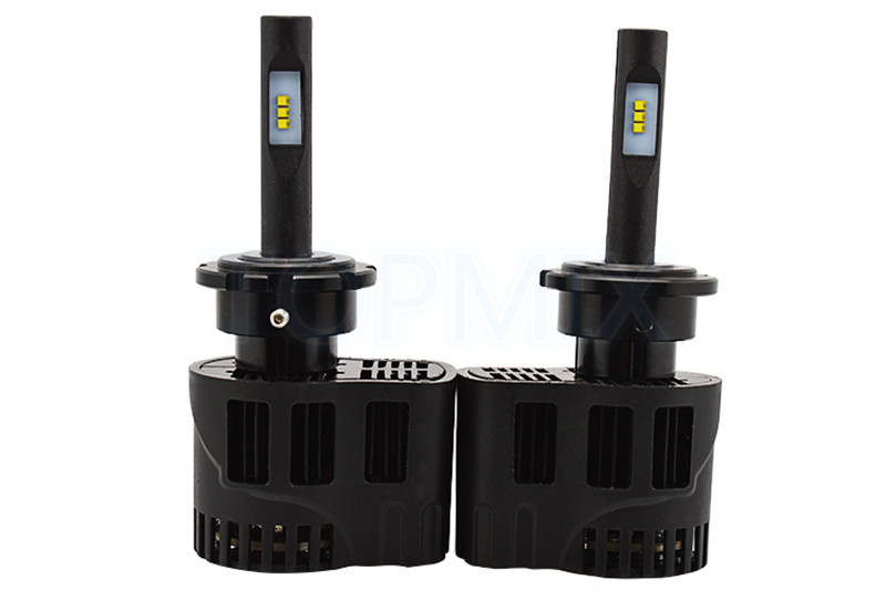

So an idea occurred to me. Can you replace HID's with LEDs? My HIDs are quite good, but they're not great - nice sharp beam pattern, but not especially bright. I looked up the manual and saw the bulbs are 35W D2S bulbs, like a lot of cars. I never ever looked around to buy D2S bulbs before, but they seem to be common, readily available, and not expensive. In fact, they're not so different in terms of form-fit-function to other bulbs; they just run off high voltage ( which comes from 12V of course).
And it turns out that the difference between, say an H11 LED bulb and a D2S LED bulb is quite hard to see. Here's a good example, where the "bulb" is long and thin and the LED's are very small - close to halogen or HID size, which I hope might give a good beam pattern. I'm getting very tempted...
