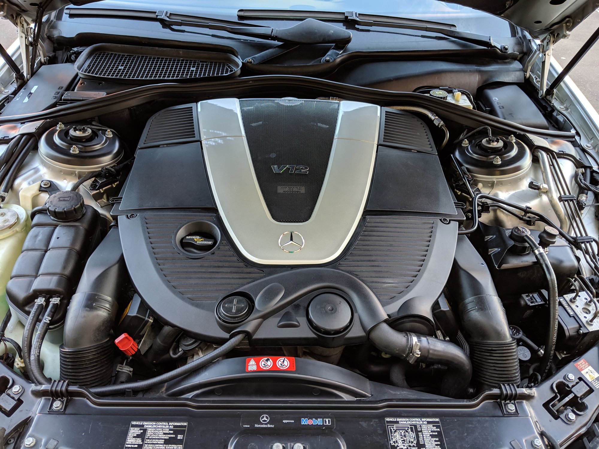

Update:
Spent the long weekend fixing the valve cover gasket so hopefully no more oil leaks!
Couldn't clean all of the residue off the exhaust so I'll just have to drive around and burn it off.
Also installed Sonnax overlap valves and TCC damper valve. Shifts much smoother now and reverse seems stronger (before it seemed like I needed more gas to get the car rolling backwards). Did the conductor plate and connector while in there. Connector was moist, but not soaked. Most of it seemed like oil from the oil leak.
Detailed the engine bay the best I could too so if there is another leak, it'll be obvious. Replaced the bad PDC sensor so front PDC works now without annoying beeps when there was nothing up front!

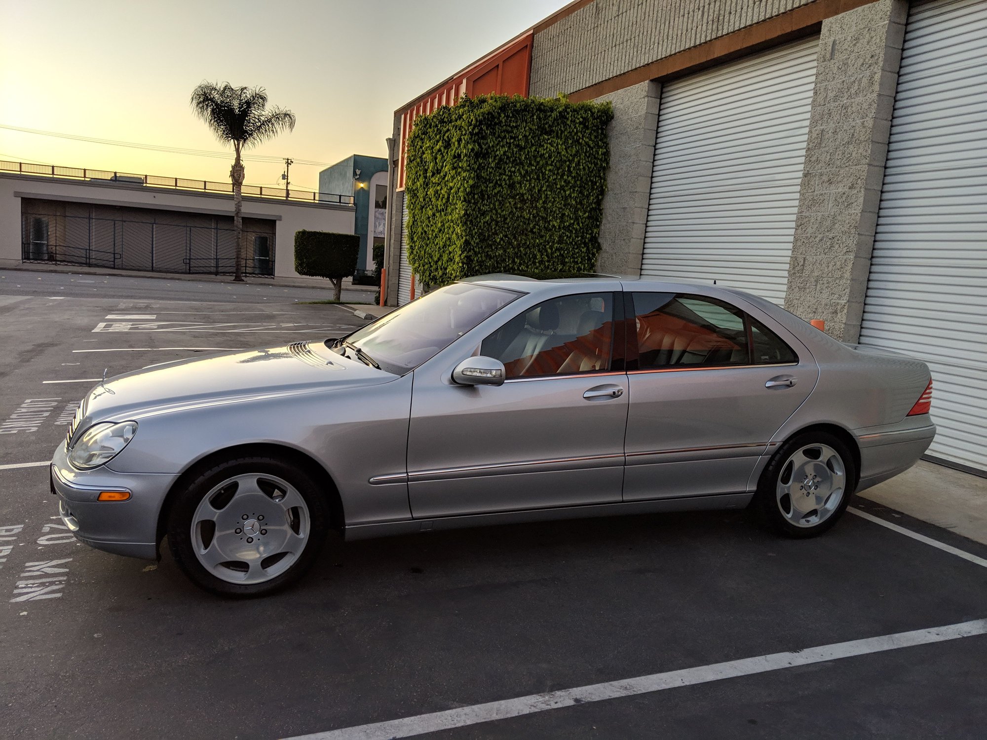

Spent today detailing the car.
- Hand washed
- Removed side V12 badges
- Mother's R3 tar / rubber remover on the front bumper and side rocker panels
- Clay bar on the entire car
- Hand polished some scratches with M105 (works great!)
- Removed years old caked on wax on the door trim using M105 + elbow grease since it wouldn't come off with clay bar or brush
- AmmoNYC Gelee wheel wax
- water based tire shine
- AmmoNYC Skin sealant
Car could use paint correction to remove swirls, but I think I'll wait until I replace the front bumper with an OE unit in a few months. Debating on going stock S600 or S65. S65 bumper will be more than double the total cost so I'm not too keen on that.
Now that the car is in a running state, my itch to mod it is starting. Kleemann tune for over 100 additional HP and ft/lb is $600 right now: https://www.ebay.com/itm/KLEEMANN-Me...e/292637579316
I like the idea of having 625HP and 700lb/ft, but knock on reliability is holding me back. Haven't really read any reports of issues from tuned M275 cars so maybe I'm just being paranoid. Would install a better IC pump if I go this route. Already have the 010 OE pump.
A few pics:

Bravo!!! It looks terrific!

Good work! She's coming back together! Glad to see that car go home to the right owner.
You should definitely look into retrofitting the full AMG body kit. It completely transforms the look of the car and flows really well with the body lines.

Originally Posted by Astro14
O-ring wraps around the coolant line and slips into turbo housing. A bit of silicone grease will help with that. I bought a 1/4" drive E10 socket to fit that very bolt. Nothing else worked for me...
Thanks! I was able to find the old o-ring. It was so hard that I thought it was part of the line. After some scraping with a pick, I realized it was in a groove on the line. 1/4" E10 socket would have helped, but was able to make it work with 3/8 E10. Used a screw driver to tap the line back into place since there was a flange I was able to get a good contact with.
Car is put back together and working now. I'm sooooo happy it wasn't the o-ring on the supply side line under the turbo.
Used DAS to reset the car after the brake lamp switch replacement. It was acting up with all kinds of ESP and brake light errors. Seems okay now.
Since the car overheated to about 120C at least twice (didn't reach red zone luckily), I went ahead and changed the oil even though it only had ~30 miles. Flushed the coolant system with a few runs of distilled water and did the same on the intercooler system.
Only code that still comes up is the Circulation Pump A31/1m1 (B1426). New pump/valve is about $120 so I may just go ahead and order it to have handy for when I wrench on the car next.
