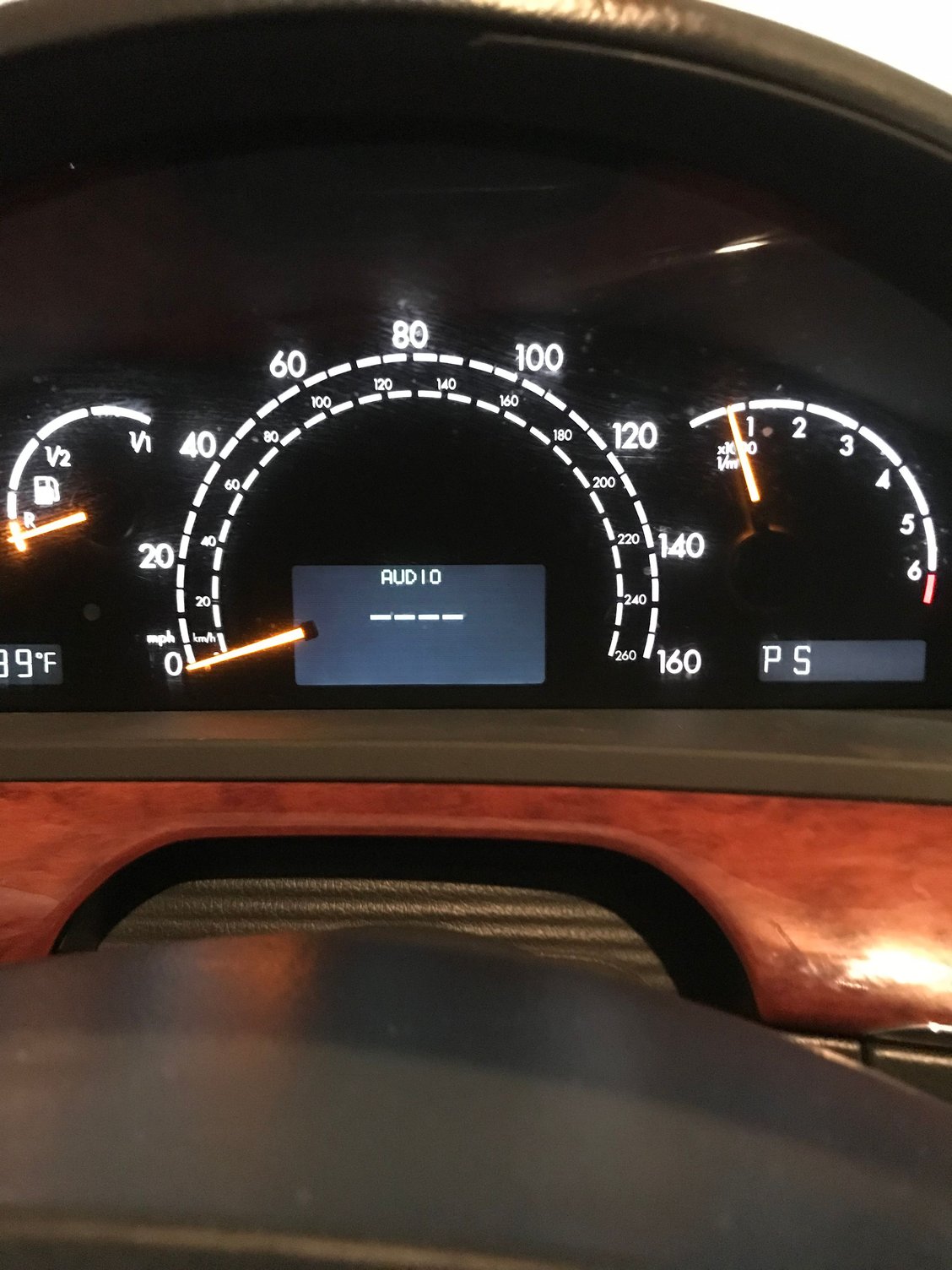

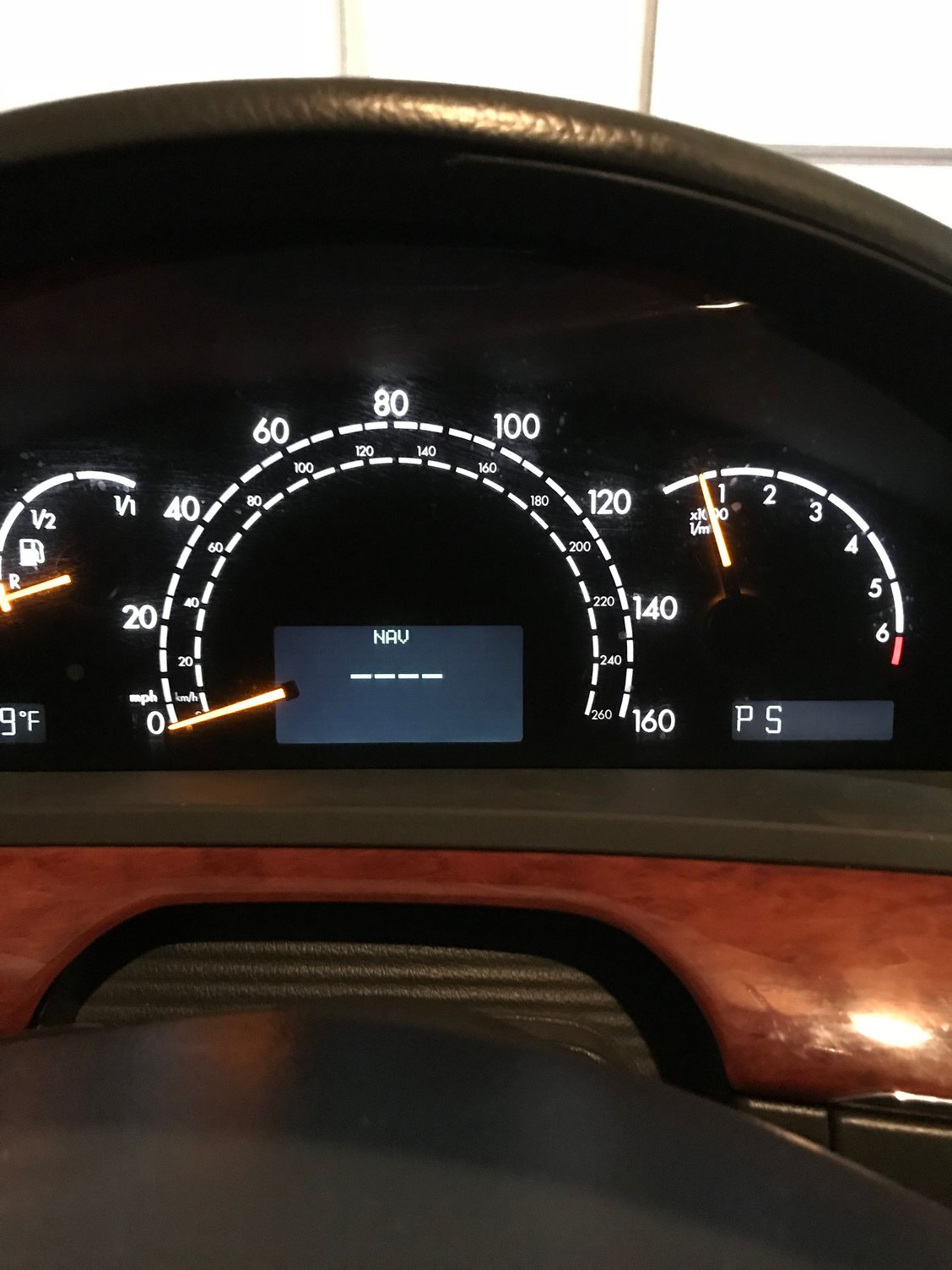

I have a 2006 s430 W220 4matic and the car has no issues no intermittent lights whatsoever, but there seems to be an issue with the cluster not displaying the odometer, nav, audio, and the time from the command unit. I bought the car like this, so I don’t know when this started and the history. Me being a computer tech thinking it could be the cluster itself, why not! But it wasn’t, I got a new cluster and the same thing is going on. I can’t change the time in the command unit and the cluster don’t show the time from the command unit. I’m think it’s a communication issue from the command to the cluster. Does that make any sense guys my vin is WDBNG83J26A484579

Thanks guys great advice, the cluster is used off eBay with miles on it. I matched the cluster with the vin#, all the gauges and lights work it’s just the mileage show dashes. I have been doing a little research and most people are telling me that i have to take it to MB and that a cluster have to be virginized so it can pull the actual miles from the EIS. I paid $4900 for the vehicle it’s a great running/ looking car but I’m contemplating spending an extra $2000-$2500 what do you guys think, is it worth it?

You get the dashes when a cluster has been swapped from another car . Obviously the cluster was swapped once before you bought it . In early cars it can be fixed but with later cars like yours , a used cluster cannot be virginized without having the origjnal cluster
the only solution is a brand new cluster abd $2500 is about right . Frankly it’s silly to pay that kind of money just to see the mileage instead of dashes - just live with it

Tusable you are absolutely right earlier models wouldn’t be a problem but the trip and everything else work like a charm. It would’ve been nice to see the info on the dash nav, and audio but the command unit is working minus the date being able to change and time showing up on cluster. The car is in great condition and have gotten a lot of compliments.
