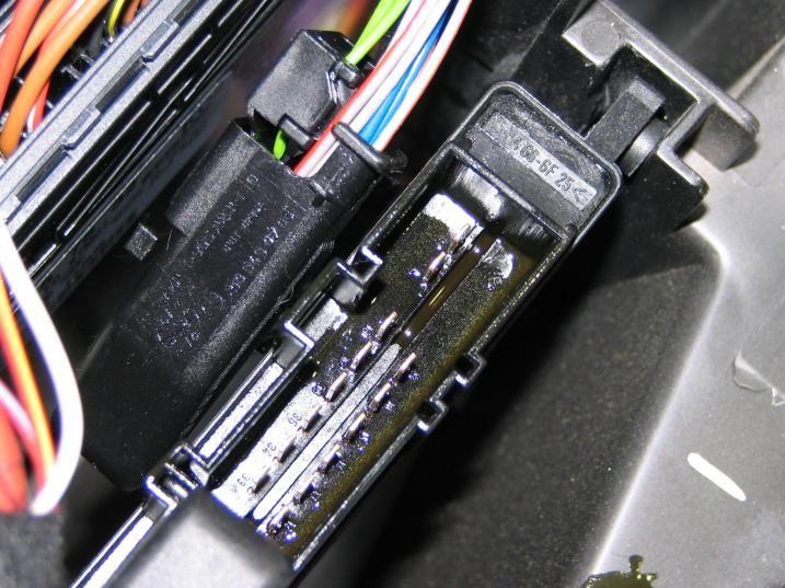

Yes I know I have to go back and fix that, I didn't drive the car too much without that capacitor.
I also want to cut the wire to the TCC solenoid while I'm there, but I cannot figure out which one it is. I know it's on terminal #17 but the plug that goes into the TCM is obscured and you cannot pinpoint where the #17 wire is. You can't take apart the plug either, and I'm not willing to break it open to see which wire it is. The wires are color coded, but I have had no luck trying to find what color wire #17 is online. It's supposed to be black/yellow according to a few 722.6 documents I found online, but none of the wires are black/yellow on my plug.

Update:
I finally found the wire for the TCC solenoid from the TCM and cut it.
This revealed 2 things:
-The jerking/hesitation went away
-The car is now in limp mode and won't change gears (CEL is on)
I'm kind of in a pickle here now - the fault detection for the TCC circuit is clearly working, but why does is not throw any fault codes when the wire is connected? There is clearly something wrong with the TCC clutch, since the car works perfectly with it disabled, but it never threw any codes until I cut the wire. It makes no sense. I'm going to reconnect the wire now and try to figure out another way - anyone have any ideas? Will a resistor trick the computer into thinking the TCC wire isn't cut?

In a sister forum, someone reported (yesterday) that the wire is Grey/Black. I know it is of little use now, but just in case you cut the wrong one.
Post 29 in:
https://www.benzworld.org/threads/bo...#post-17976424
