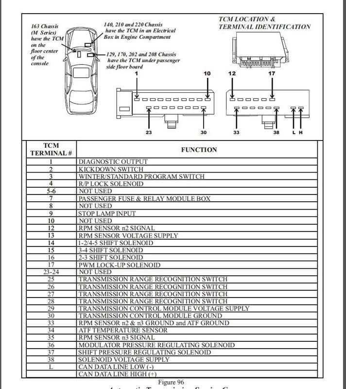

Ok I found the wiring diagram for the TCU and the wire that signals the TCC to activate.
If I disconnect wire #17 then my problem should theoretically be fixed. I just want to know before I do anything - will the transmission go into limp-home mode if I just simply disconnect it? Will the TCU freak out? What is the proper way to go about doing this?

Has there been any development? If not solved yet, I would recommend you change the solenoid and electrical plate.

To 'permanently disable the Trans convertor clutch, disconnecting terminal 17 should do that without any problems. It MAY throw an error code such as 'TCC solenoid failed open'
I would simply locate the wire at a convenient location and cut it. sealing each end to prevent any chance of moisture or a short.

I would cut the wire and insert a single-pole, single-throw toggle switch in the wire in an accessible location. This would allow you to have the circuit on or off with no problem.

Does anyone know which color the wire is? I cannot pinpoint which wire goes to the #17 terminal.
Have you ever thought of becoming an automotive tech? Don't!!
You have ignored / dismissed everyone who has posted and you also imagine that you're way ahead of the engineers who designed the car.
You are completely delusional and have no idea what you're doing!
I would not want to buy a car (half-assed and hacked) from someone like you.
You think you're the only one capable of fixing it? Laughable. Among other things (many), you can't even figure out which wire
to cut, going to the TCM. Despite posting the schematic! LOL.
