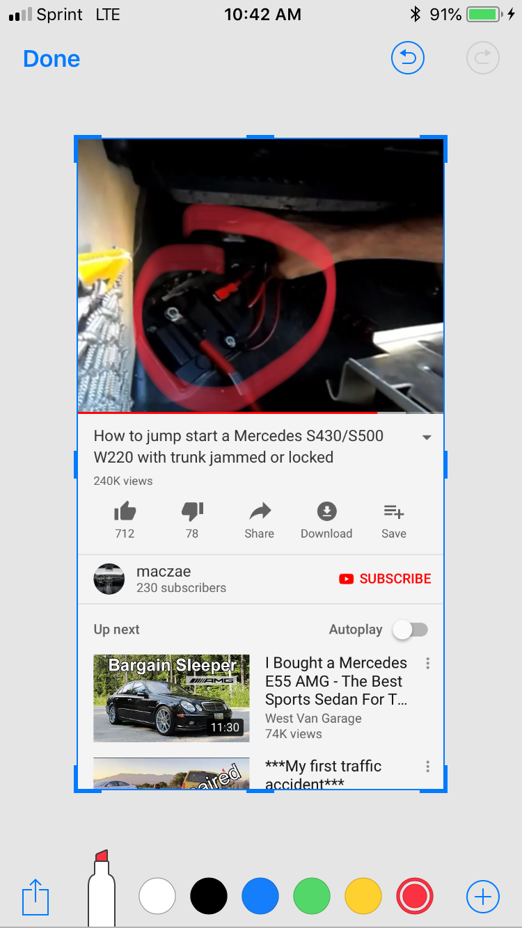

There’s One black box under the passenger floor metal cover . The one with the thick battery cables in the video . Did you even watch the video and see the black box or are you just being difficult and argumentative ?
that black box under the floor has large main fuses inside it . If you apply power there as the video shows you how to do it , and you don’t see things powering up like the inside lights, headlights , can’t use trunk switch on the door , then your main fuses inside that black box. Are blown .
If things do power up when you apply power as directed in the video you should be able to just pop the trunk using the release button on drivers door . Then you can put in a fresh battery

Here’s a picture , taken from the video this box under passenger floor has large main
fuses inside it
