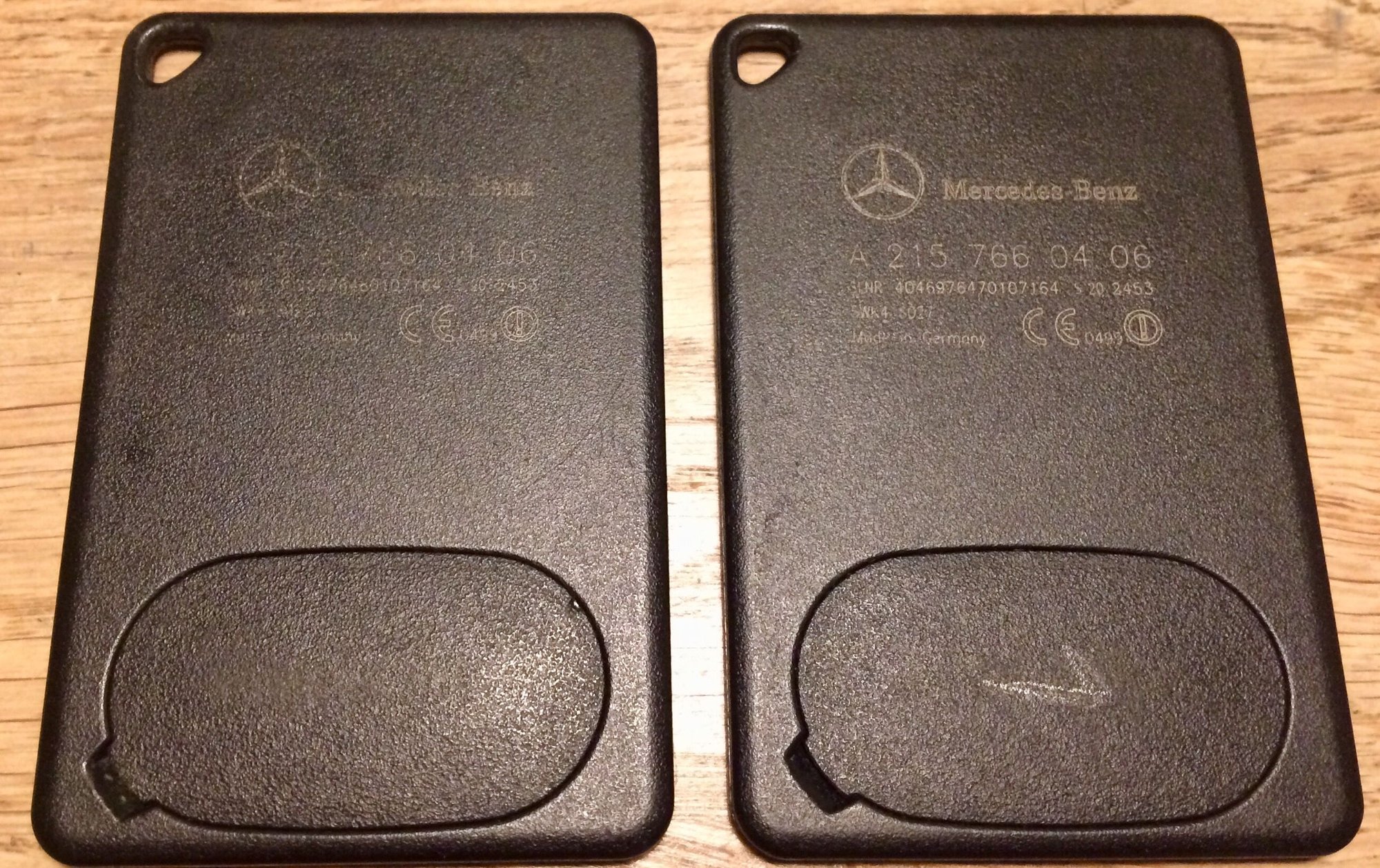

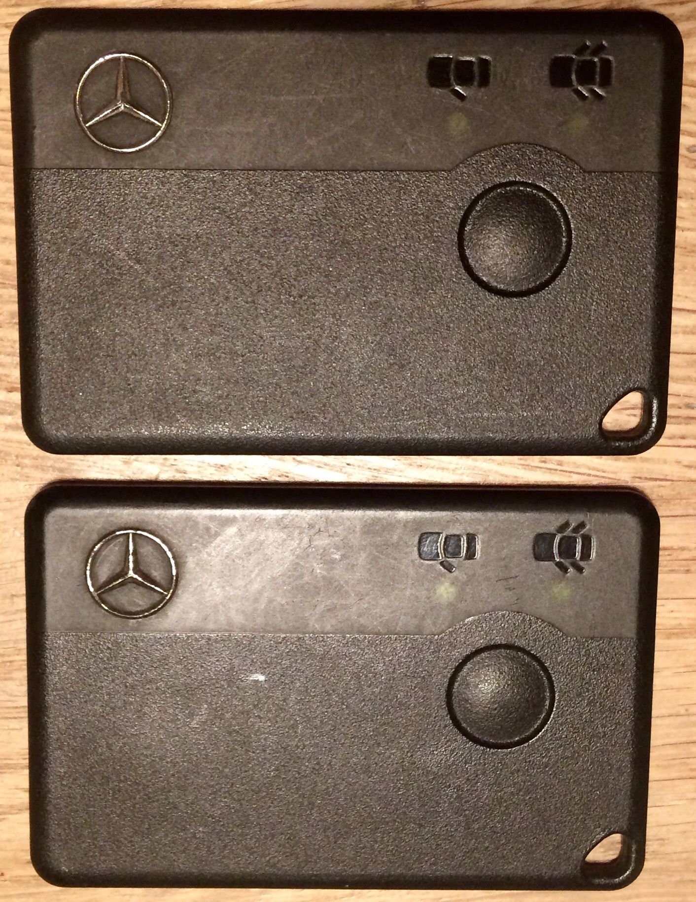

Dear all,
This is about my W220, 320, CDI, 2003.
My challenge is:
The car is closed.
The car opens perfect when I go up to the drivers door.
I sit in, and close the door.
Then I press the button on the gearshift, then the steering wheel and seat goes in position, then it lights up in the drivers display.
Then I press one more time on the gearshift, now it’s seems that it goes to the ignition position.
The motor don’t start.
If I press one more time on the gearshift, it’s like when I stop the motor with the normally key.
The seat and steering wheel first goes in out position when I open the door.
What could this challenge be?
Please see photos.
Thank you very much.

what puzzles me is the fact, that your key card has a part number of the CL500 A215......, even your car is a W220????? Maybe someone swapped the keys, and they may work for the doors, but not with the ignition security system???? Leaves me behind with no clue??? My key-less-go card has a A220.......number.
