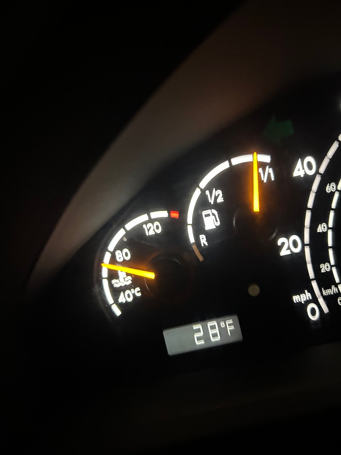

Last silly question for a bit
When the heat is on it seems to be quite hotter when the temp gauges are above 80 in stop and go traffic once it gets to 80 or slightly below the center vents turn somewhat cool . Now I know I’ve seen threads where they’re saying the center vents on mb are meant to blow cool rather than hot . Is this true (2004 s500 4matic )
Old Dec 23, 2024 | 08:48 PM
Sourwaves's Avatar
Joined: Dec 2024
Posts: 13
This is how low the temp gets when consistently driving , was going about 80mph .
