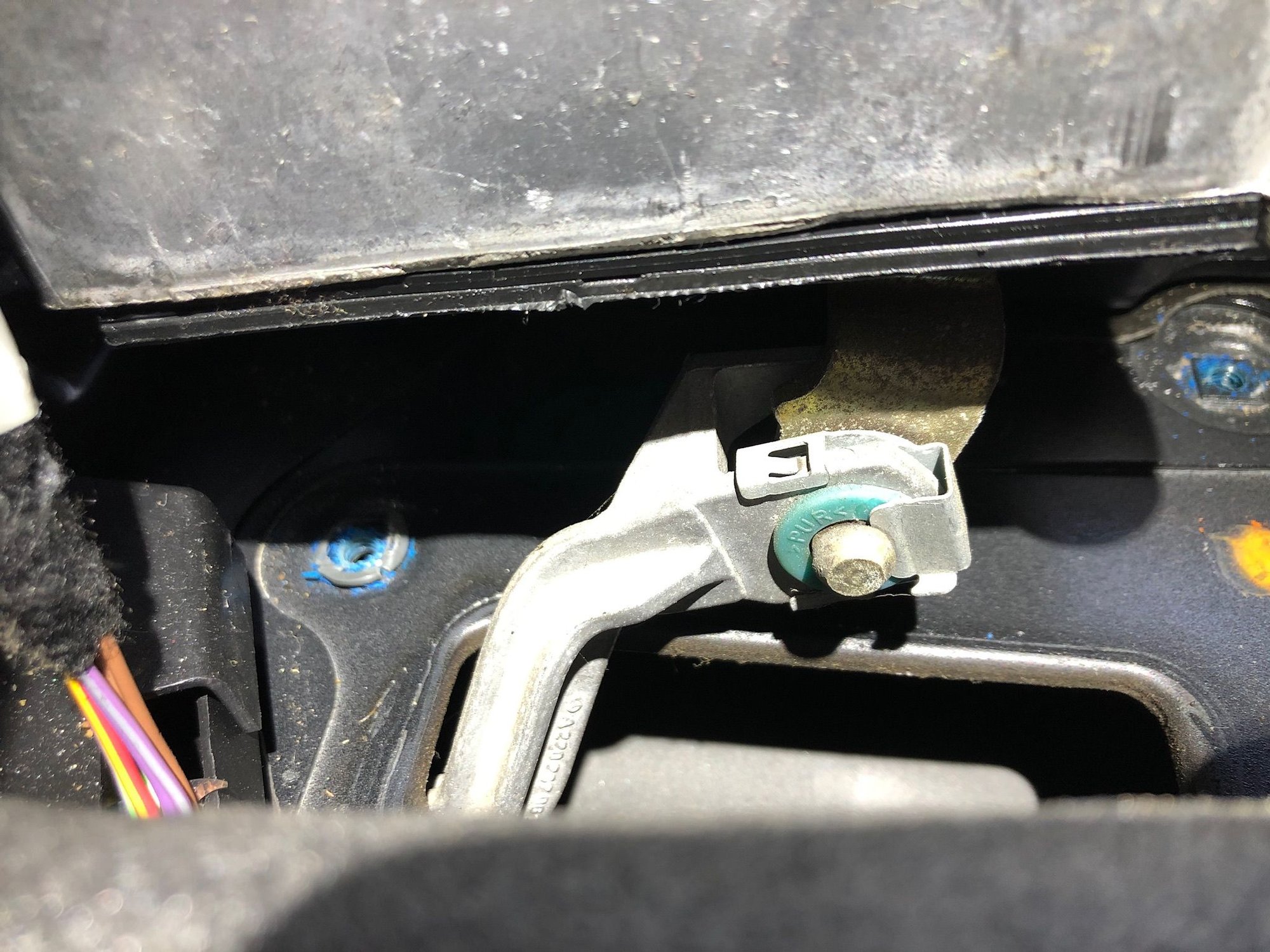

The clip on the bottom of the shifter:

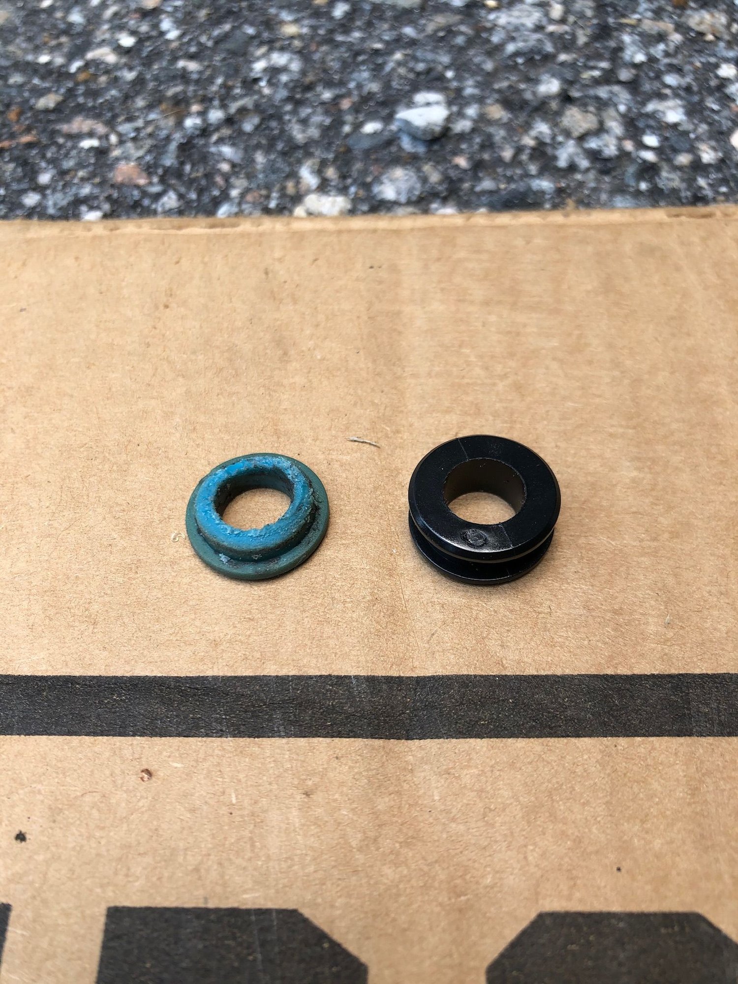

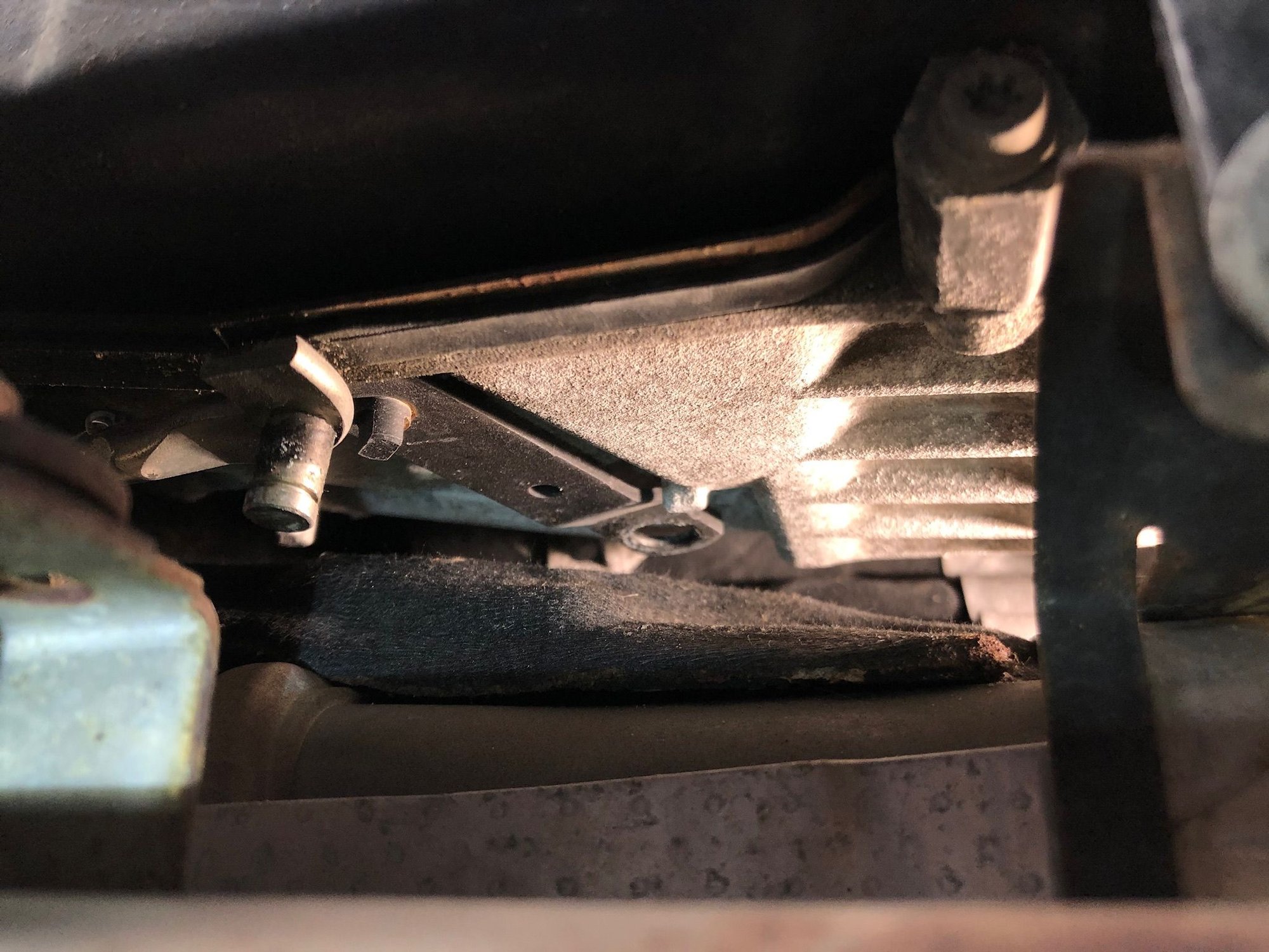

2005 S600 2005 SL600
The bushing on the transmission end, showing old (blue) and new (black). This was the cause of my shifting problems.
Both the shifter end, and the transmission end, are the same part number. And the new part is black, not that aqua blue of the old part. Also, not a lot of room to work in the transmission tunnel for the bushing that had failed on the transmission lever...
