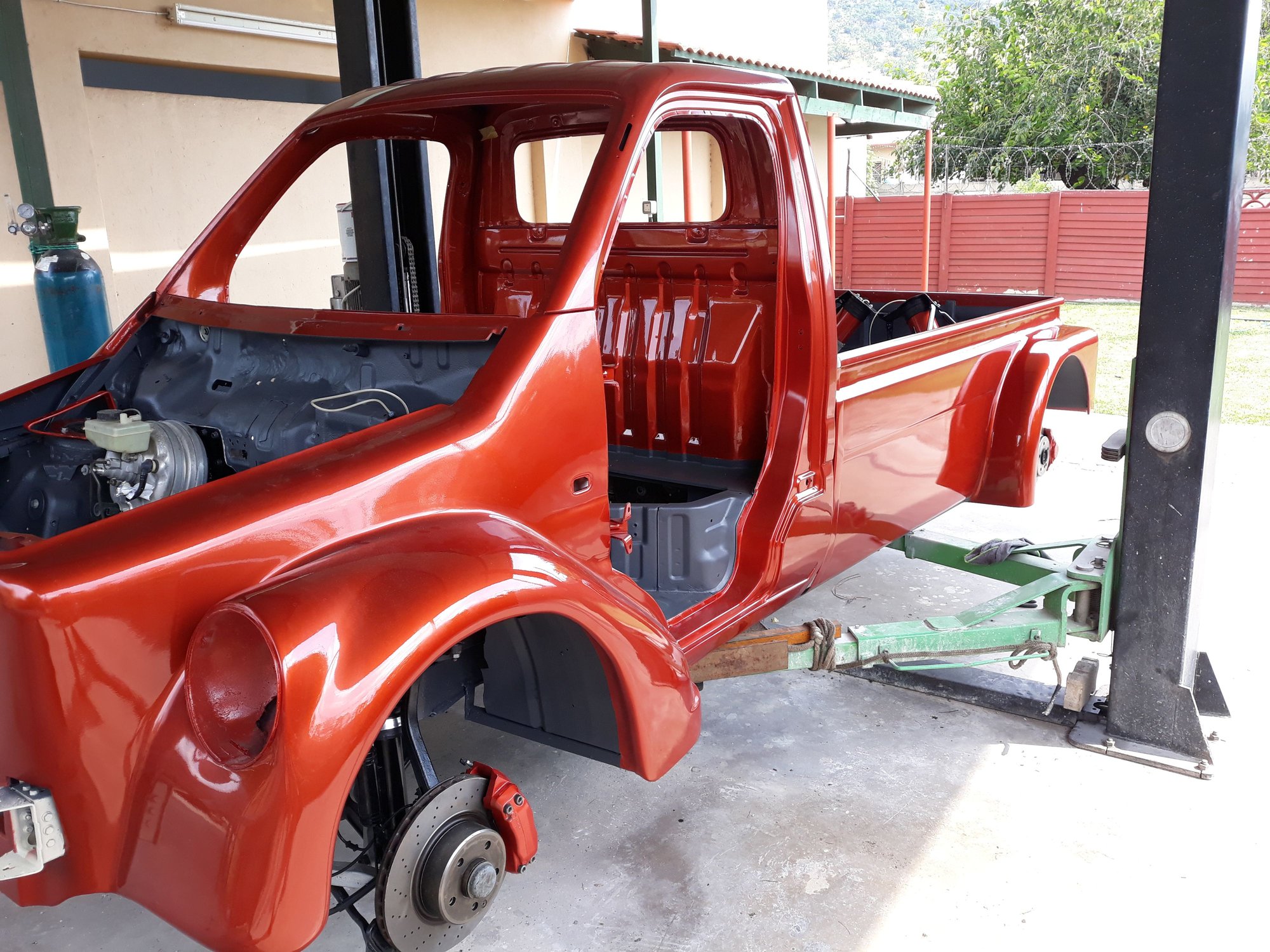

Hi Guys, I've got hold of a 2006 year model w220 s320 which is
damage beyond repair. I've decided to transfer all the the systems into a small delivery truck, big job I must say, but managed it.
I've started on the wiring and it will be a bit tricky. Some systems will not be used and others must manipulated to make it run again, I hope.... My biggest challenge now is to get hold of a complete wiring diagram of this car. Hours and hours of searching on the net did not bring me any luck, can somebody guide me to a decent diagram?
