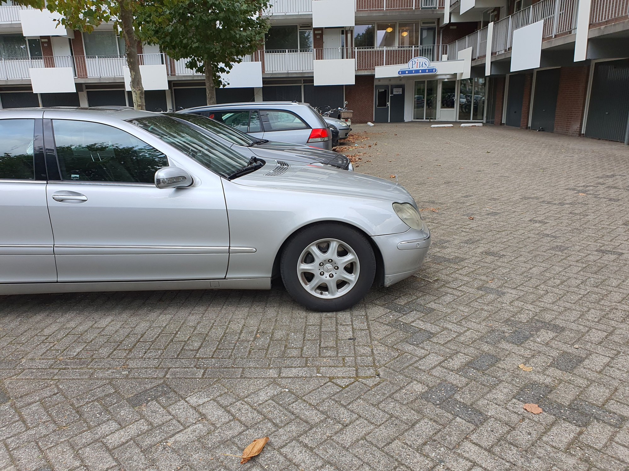

Here are two photos. First is with suspension lowered. Second is raised. The lowered setting definitely looks very low to me. Both sides are consistent however. If I leave the car for 2 days on the RAISED setting, it does not sink back down.
Even the RAISED setting seems a bit too for me. It could be that as someone suggested above the car has been previously lowered.

The front suspension appears to have definitely been lowered, whether purposefully or accidentally. You might start by finding several photos of the standard appearance of the front ride height sensors, and comparing yours to the photos.

It certainly looks much lower than it should be. That's why I was concerned.
That's also probably why the previous owner said he drove it all the time in RAISED mode. He said it was because he liked the ride better when raised, but I suspected that there was another reason.
At highway speeds it will lower itself anyway.
