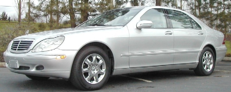

Btw, here is the pics of my S430 yr2000. It currently has OEM Chrome 16" wheel (7spoke)

Those Ebay wheels look pretty good.....Are they 18"
Also in those pic's showing the new wheels, that's an 00'-02' Sclass w/all the 03'-on up lighting upgrades, thing is I haven't seen one w/the 03'-on up mirriors installed. I thought it might not be possible but obviously they work!
If you didn't notice the 00'-02' difference from the new 03'-04' besides lighting is the hood design (The way it intersects the bumper) the older model has a smaller grill too.
