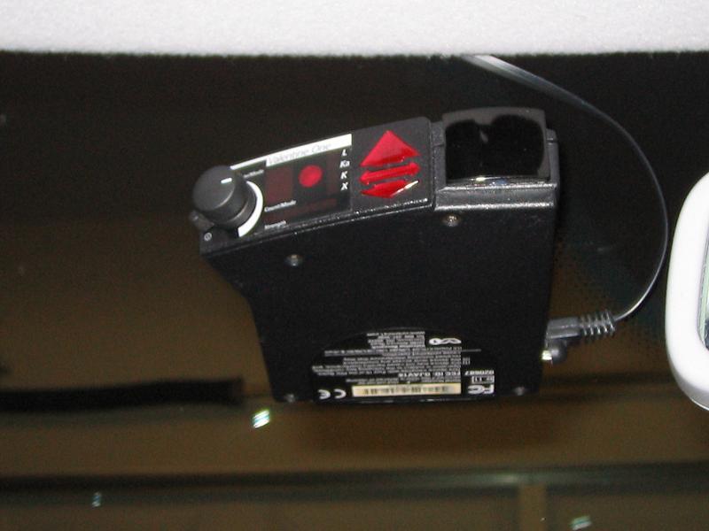

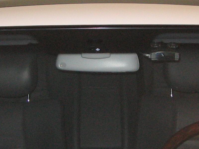

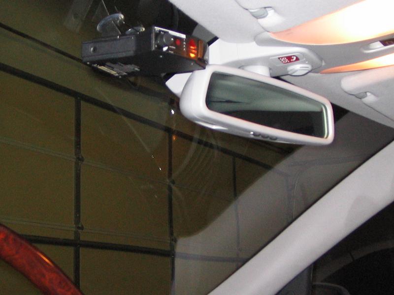

I have my Valentine hardwired and mounted high and to the left of my rear view mirror. In my opinion it works at about 70% of its potential versus it being mounted in my Ford F-250. As far as testing it, I got lucky one day and ran into a speed trap, pulled over, and moved my Valentine around until I got the highest signal. Seems to be working fine for me in the S55 however, works alot better in the F250. I'm still searching for another way so my detector can work at its 100% potential. I'll post some pictures later this evening to help you out.

Here are the pictures I promised...
I know I said yesterday evening but it was late and I have a dial up connection at home so you understand. Sorry TheRicker, I will have pictures of my car soon. I don't own a digital camera and finally got a hold of one yesterday but it was too dark outside to take any good pictures by the time I got home. Anyways, glad to hear you finally got your bixenons! Man, I'm jealous! How much did you pay for those babies?
As far as hardwiring it, I ran the wire across the headliner, down the side of the driver side pillar, and down under my dash. I connected one wire to a switched 12volt power source under my dash and the other to the negative ground wire. I used a probe to test to find a positive wire when the ignition is switched on. I wish I could remember the color of that wire. I would have to go under my dash and remove the panels to take a look. Let me know if you need that information. I'll take a look if you do. Good Luck!

I GREATLY appreciate the pic's, the info, and your willingness to share your knowledge!!! I will try to do the hardwire install this weekend & let you know how it goes. The location that you have pictured is where I had the Valentine before I relocated to within the black dotted area. What is this area...the radio antenna? Thanks again.
