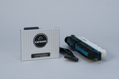

Carlsson plug and play
Carlsson is the only one to have a true plug and play solution. 5 minutes installation, it's been in the market for about a year. Everybody else is way behind of the subject. Cutting and splicing on MB is a crime!
