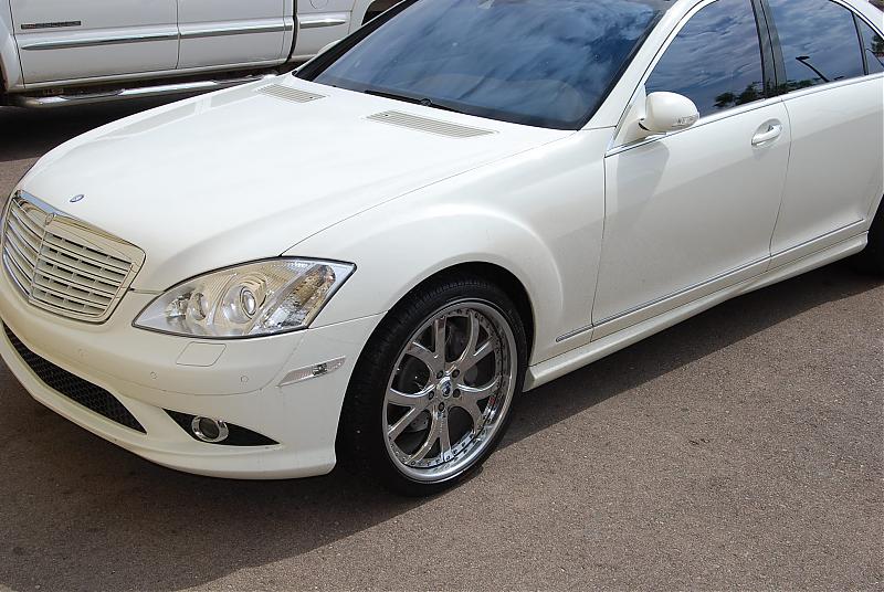

easy 5 min. job. great product, fast shipping from the ebay member listed. included yellow bulbs.

took my grill apart and painted it white too, what do you think? also removed the star on the hood and replaced with star badge.
