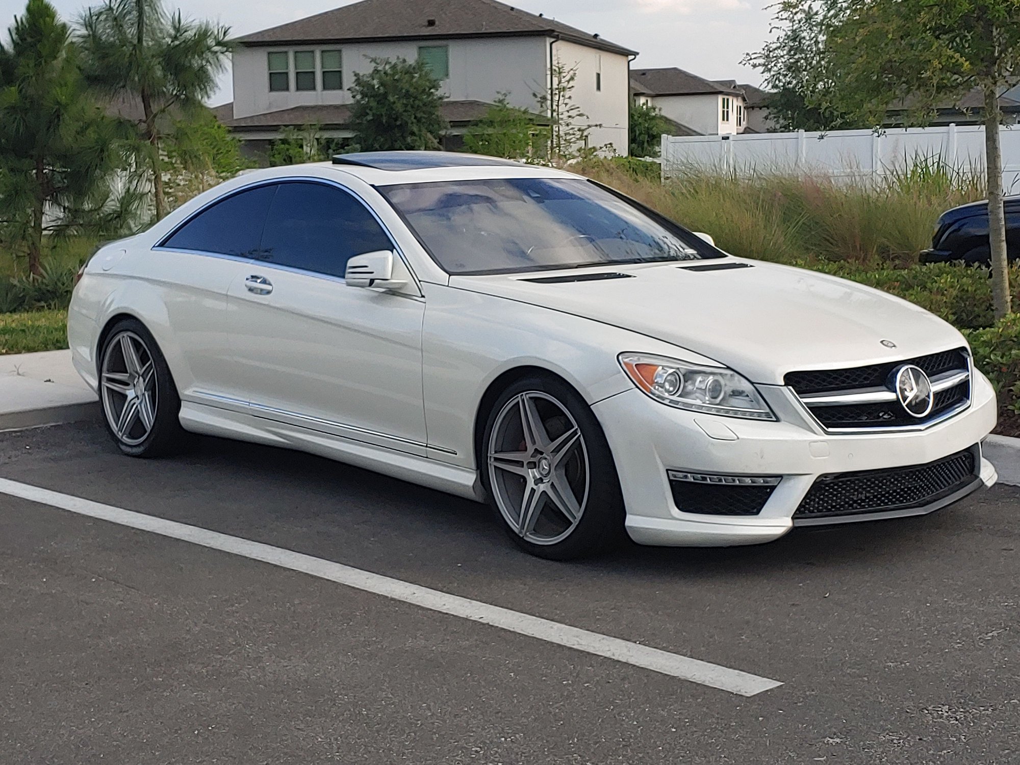

Old Jul 2, 2024 | 12:33 AM
Aviam's Avatar
Joined: Oct 2023
Mercedes CL550
Mercedes RWD CL63 front calipers on 4MATIC AWD CL550 POSSIBLE?
Originally Posted by irieblue
The CL 550 uses the exact same brake parts as the S 550, so of course they are interchangeable, you also won't gain any new stopping ability.
The CL63 uses the same brakes as the S63 which are the same as the S65, i.e Continental supplied Twin Sliding Calipers, they would be a major retrofit to get onto the S550's stock hub/axle, and are not worth the effort...
The SL 550 has slightly smaller brakes than the S550 (13" vs 13.2"), so that would be a downgrade in stopping ability...
The SL 63 has 14.2" Brakes with 6 piston calipers.. These would be the ones that would make a nice upgrade (I believe they are the same as the E63 and C63) , but like I said, a set of 16" Brembo's would be the ultimate upgrade if you are going to go that route..
Lets be clear on one thing.. Neither Mercedes nor AMG make brakes themselves, they are contracted out to Brembo/Continental/GM suppliers...
So the CL63 being rear wheel drive. The front 360mm rotor brake calipers would or would NOT fit CL550 4matic it being 4 wheel drive has a different spindle?
I have 20 inch wheels & was thinking of that upgrade.
I found CL63 calipers fairly cheap & can also upgrade to 360mm front rotors replacing my 335mm front rotors if the CL63 calipers mounting bolts line up? And would i have to do rear wheel as well or i cdn leave original cl550 Rear calipers alone without any balance issues?
Seems like u understand more that the rest do if the rwd CL63 front calipers can be used on the 4matic 4x4 cl550 would be the answer id want & what if any retro fittings. If worth the work? Asking if front calipers bolts match up on CL63 & CL550. Are or are not the same?
Thank u in advance
