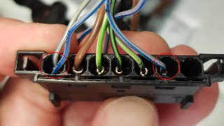

Guys, I don't want to reinvent the wheel, and multiple times in this thread a "crosswire" is mentioned. Can anyone confirm what do I cross with what to make this work?
this is the connector I have:

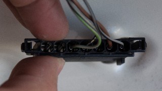

I'll answer myself: bridge pin 7 with non-existing pin 2 and you will get results:

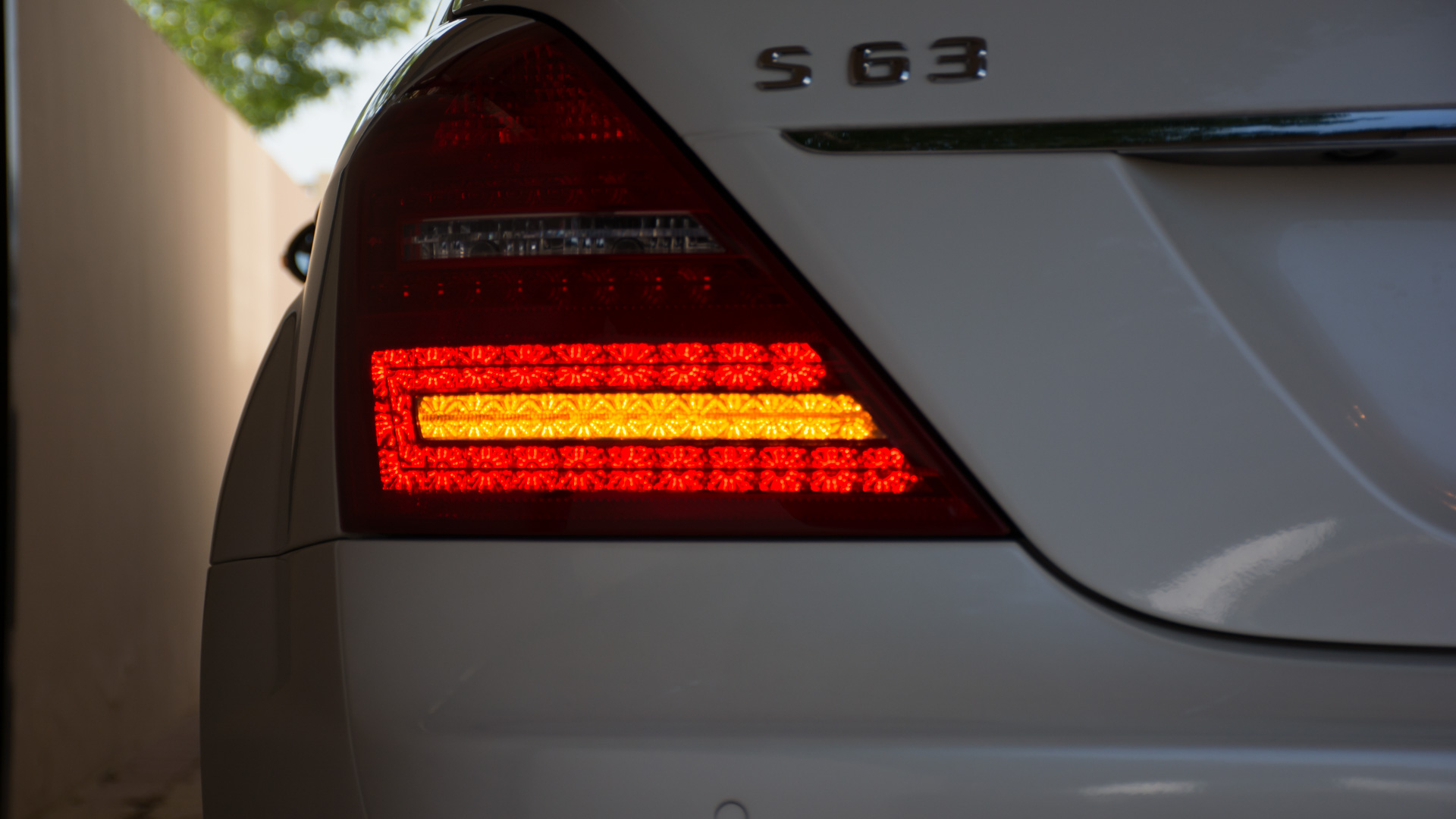

no sir, I am not talking about amber lights. If you try facelift lamps that are not dedicated to pre-facelift car, it will not light up the upper half of the lamp LEDs... that's been discussed earlier in the thread and folks were mentioning crosswire fixes... but I was unable to find the actual fix recipe. So I figured it out myself and all is looking sweeeet now!

On my pre-lift 2008/9 it was pin 7 bridged with unused pin 2 (on the other side of the car the numbering is mirrored, so it is PIN 1 with pin 6 - either way, first wire (blue/white) must go into first empty one). I managed to get a hold of a wire harness, so I harvested pins from it and re-used. On the picture below PIN 2 was the one that was missing.
