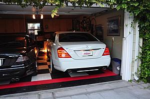

The dealers typically don't like dealing with mods, you'll have to find a tech that will work with you. Ask a service advisor at the dealership if they know a tech that can do it for you.
Right, 100% doable, but not without the rear SAM. Here is a picture of my wife's car ('07 S550).

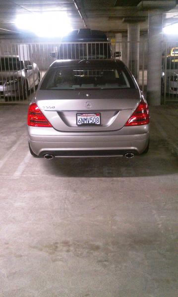

Facelift S550 rear brake lights, plug-n-play, no errors, top and bottom rows light up wihen applying brakes, went with smoked instead of clear on pewter body, looks great imo. Purchased from Express Body Parts Inc, North Hollywood, CA, installed in about 15 minutes by recommended local MB body shop, parts and labor 487.00. Express is working with its supplier to possibly secure plug-n-play front head lights and DRL's, no date on when they will have it, but I will definitely update this thread if and when they become available because I do not want the hassle of the errors, new SAM's and reflashing seemed to cause everyone else that has gone OEM.
