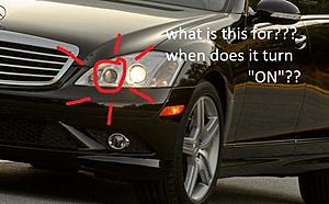

Who knows what THIS light is for??????? and please explain!!! cuz either I'm a little retarded or..... MERCEDES-BENZ is when they designed this car

Highbeam?

When you turn left, the left one turns on. When you turn right, the right on turns on. It just makes sure to light the path where you are turning towards.
At least that's what it does on my car. Not sure what it does on US-spec cars...

I believe both jtanoyo1 and QuadBenz are correct, someone posted a thread about this a few months ago. I haven't tested the theory myself, but I' pretty sure that the center lights are for the high beam and the integrated cornering lights.

This is the IR (Intra Red) headlight for the night vision system. It puts out IR light which can only be seen by the camera. If you do not have night vision, I suspect that it may be a dummy bulb.

Finaly a guy who knows about S-class's :P yea... It's the IR. I didn't jump in front of the car to see if they go on when you steer, but that might be also true. Question! Why does nightvision not work with the headlamps turned off???

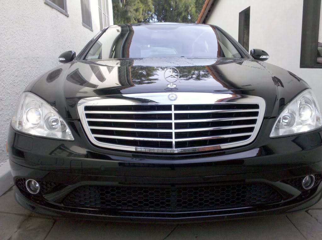

Regular setting - low beams
Close up of that
low beams + high beams
Close up of that as well

If your low beams are not on when you flash you high beam, only the halogen comes on. That's the function of the bulb the OP circled in his attached image.
If your low beams are on when you flash, in addition to the halogen high beam bulb (as shown in quadbenz's pics), the bixenon feature means that the lowbeam bulb also emits light at a higher angle (via a flapper activated when u pull back on high beam stalk).

This usually causes some confusion but the post with the page from the US version OM is pretty clear. The lamp in question may be on of two things. If the car does not have Night View, it is the xenon high beam. If it does have Night View, then it is the IR emitter and both high and low beam xenons (hence Bi-xenons) are handled by the beam on the outer portion of the headlamp. For USA, all 221 models have Bi-Xenon headlamps as standard and therefore Halogens are not used for either main of high beams.
