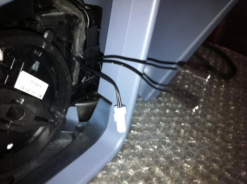

Hey Chris,
Do you know what the additional white tipped connector is inside the drivers side mirror? There's only two contacts on the actual mirror.

W222 S63L, ML/GLE350
It is if you have the dimming option and pay extra for that type of glass.

Thanks Chris, I figured it was that or for lane departure.
Chris,
I have the same connection with the wing mirrors except my dimming connection is on the left and I need that cabling (white connector) f
on the right hand side, as I have already ordered the mirror this will not work correct?
Can this be modified to the right hand side?
I have no clue.These are not made for RHD..But I think it should only be to move the cables to the other mirror and it should work just fine.

For you that installed the facelift mirrors.......
Try the memory thing firstly in the post below and let me know if it works.
I also checked all the pins now and YES there is a difference on the old and new...
If this is a solution they might have pined them all wrong and differently wrong so best way is just to pin it the way the old are and they are as this:
Blue 1 to 9 white
Blue 3 to 8 white
Blue 5 to 10 white
Blue 7 to 7 white
Blue 8 to 4 Black
Blue 6 to 9 Black
Blue 4 empty
Blue 2 to 3 Black
