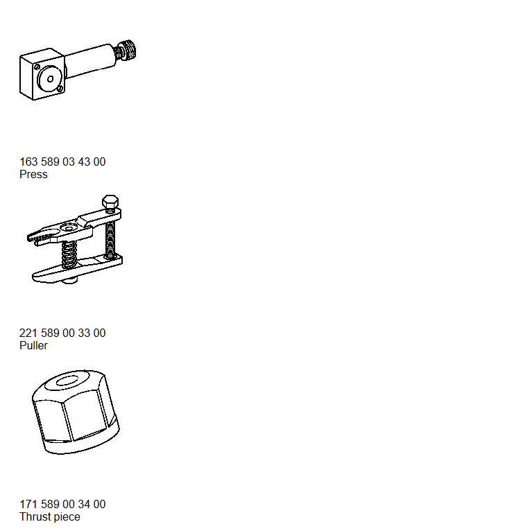

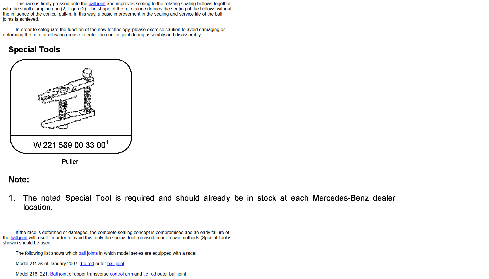

I'm wondering what specific ball joint puller everyone uses for the front torque and cross strut removal. The manual for my W204 shows the same 221589003300 puller used for removal. They seem to cost over $200 which is a bit much. Or is everyone using the MB tools?

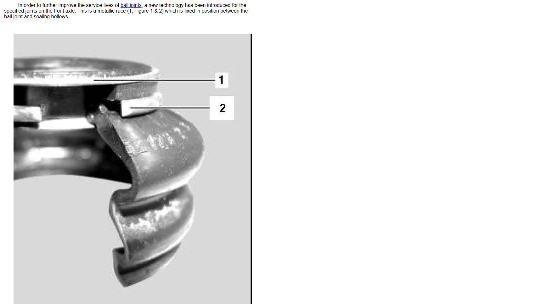

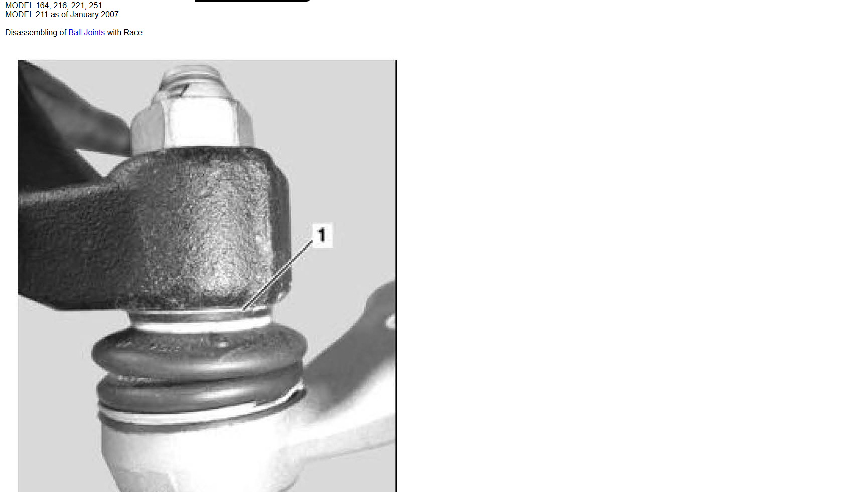

In the manual there is a note about the ball joint design:
Guess it only applies if working on the suspension and needing to remove and reinstall the control arm.

OP your local MB dealer may not stock the tool but they tend to be two days away if you are close to a parts hub.
The hour of labor you are not paying at the dealership pays for that tool and now you own it. An hour pays to replace ONE outer tie rod on a good day. More for ball joints.
The tool pictured above is the right way to do it. The mobile tool dealers all offer a similar tool. Snap-On, Matco, Cornwell, MAC. The MB tool works best.
Where the suspension upright is steel one can beat on it with a BFH with the nut removed to get the ballpoint/tie rod end to pop out but the upright will pay for it if you are not skilled with hammer blows.

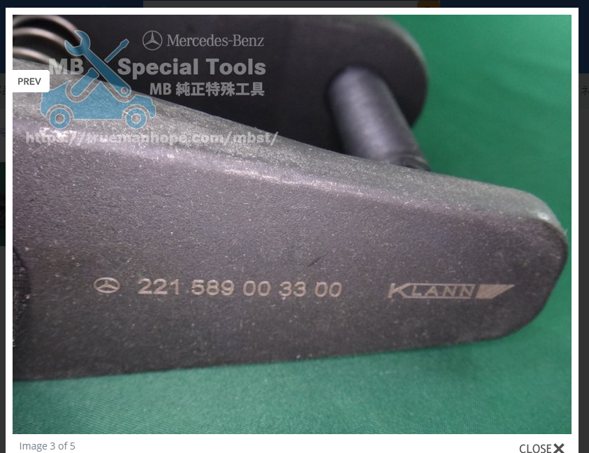

A photo I came across of the MB ball joint puller says Klann on it. I read Klann is now Gedore.
I have a tool for the rear spring control arm bushing in the wheel carrier from Gedore. The W221 and the W204 use the same tool but the W221 uses one tool for removal/install and the W204 uses two tools, one for removal then another for install. But the Gedore tool is made specifically to be able to remove and install. Its great because it costs the same as one tool and does both jobs.
Wonder if the current MB ball joint tool is a Gedore product? Im not finding any current photos of it.
The W204 has another bushing in the rear wheel carrier for the thrust arm and the only tool I could find is the MB tool so was stuck buying it. Theres no other stampings on it for who made it. The Gedore branded bushing tool seems made better in my opinion.
