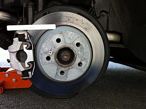

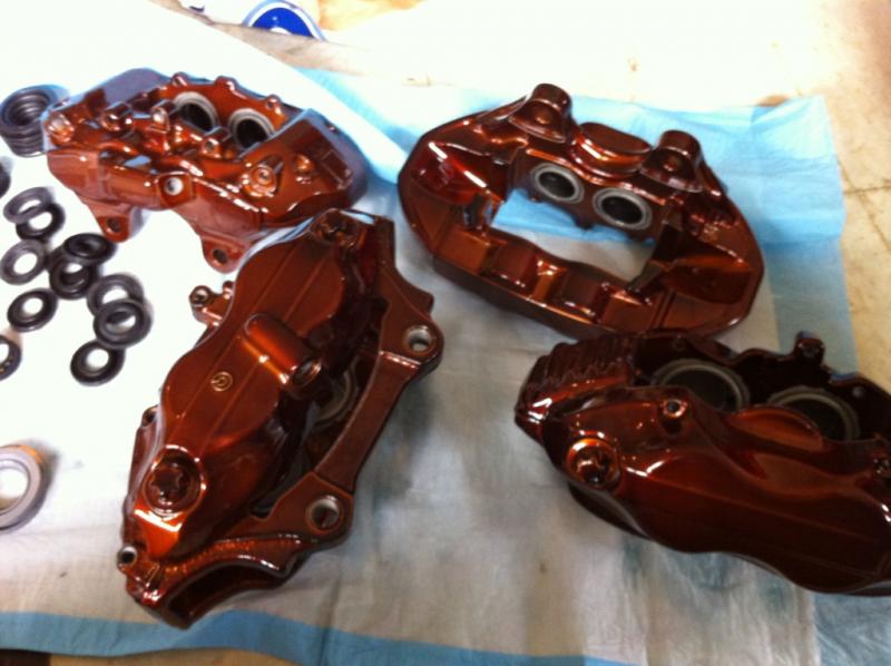

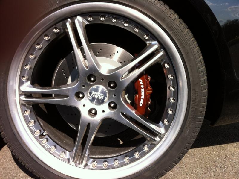

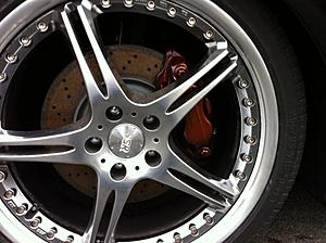

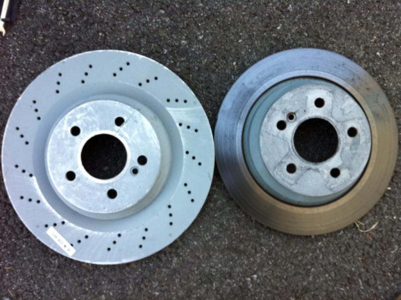

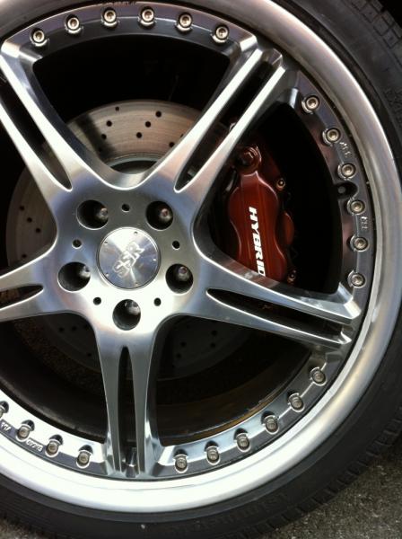

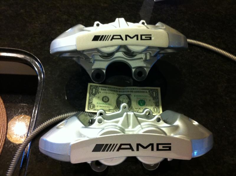

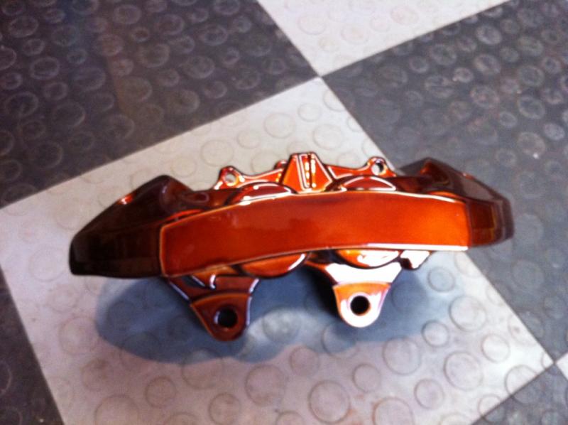

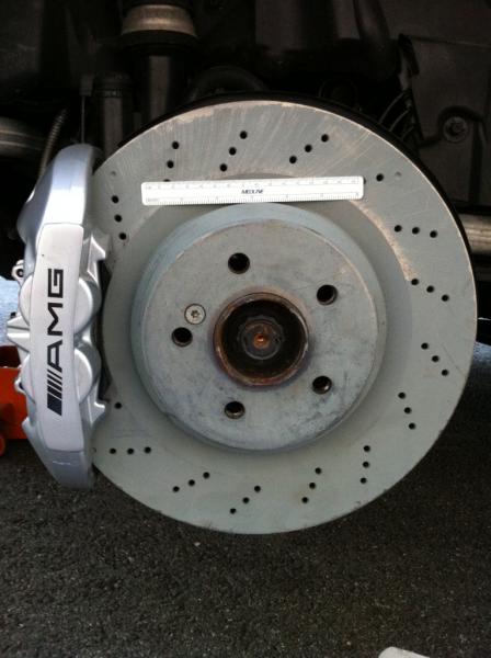

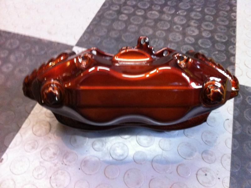

got my rear euro spec s600 calipers upgrade from MBenzNL last wk. huge difference in size. perfect fit. used oem drilled rotor from SL55 and pads from SL65. almost the size of the front calipers but 1/2 the weight. people with 20" or above wheels- don't leave home without the upgrade. the hardest part was to find the caliper rebuild kit since i powder coated the calipers. the install was very easy.

the price went up from 2 yrs ago so i only got the rear. i think the front looks pretty decent already. however, i think most of the cost is shipping the heavy rotors and pads. i think if u only get the calipers, it will be very attractively priced. i looked at other bbk but i don't want to loose ebrake. the price for just the rear caliper is very reasonable. i'm glad i only got the caliper because i was able to upgrade to the sl55 drilled rotors (thanks to iriblue). the is a must if you have large wheels. p.s. i think 18 should still clear because they are still smaller than the front brakes.

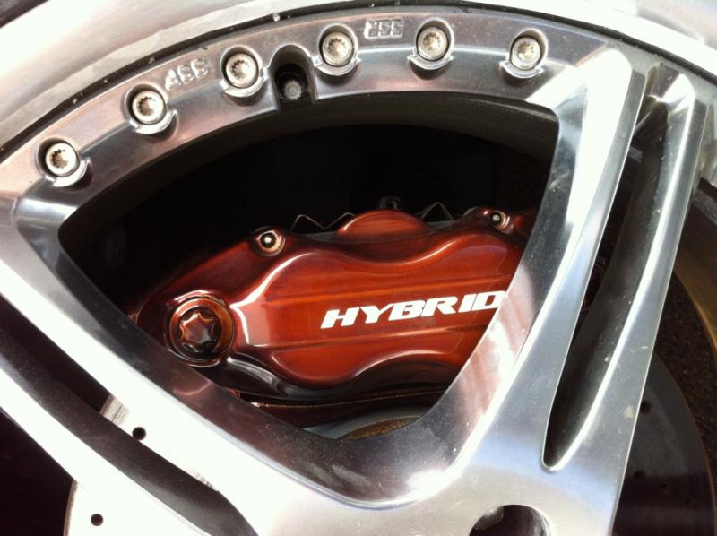

the first 2 pic show the front, the 3rd shows the rear. each floor block is 12".

rebuild kit is only if you are going to powder coat it. you could salvage the old one too. i got mine directly from brembo in ca. shipping cost as much as the parts. use
http://www.harborfreight.com/hand-to...set-66836.html
to pry off the old dust shield. be careful not to pierce them. the front replacement are made by centric. not as good as mb/brembo but fits.

what size is the w211 e55 rotors? got a pic? you guys think the front rotors are too small?
Old Apr 4, 2012 | 02:40 AM
Chris The Swede's Avatar
Joined: Oct 2009
Posts: 3,433
Likes: 212
From: Sweden, Stockholm
W222 S63L, ML/GLE350
Partnumber is A2304210712 so same as R230 as you can see. I think they are 360 36.

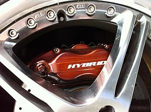

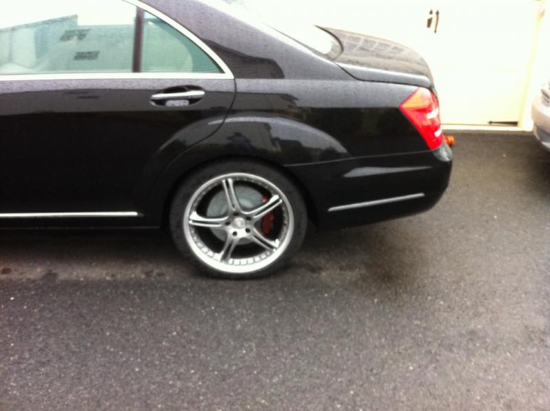

now with stickers
stickers are too small. will get larger ones soon.

Stickers adds SO much! ;-) LOVE the color on the calipers...
