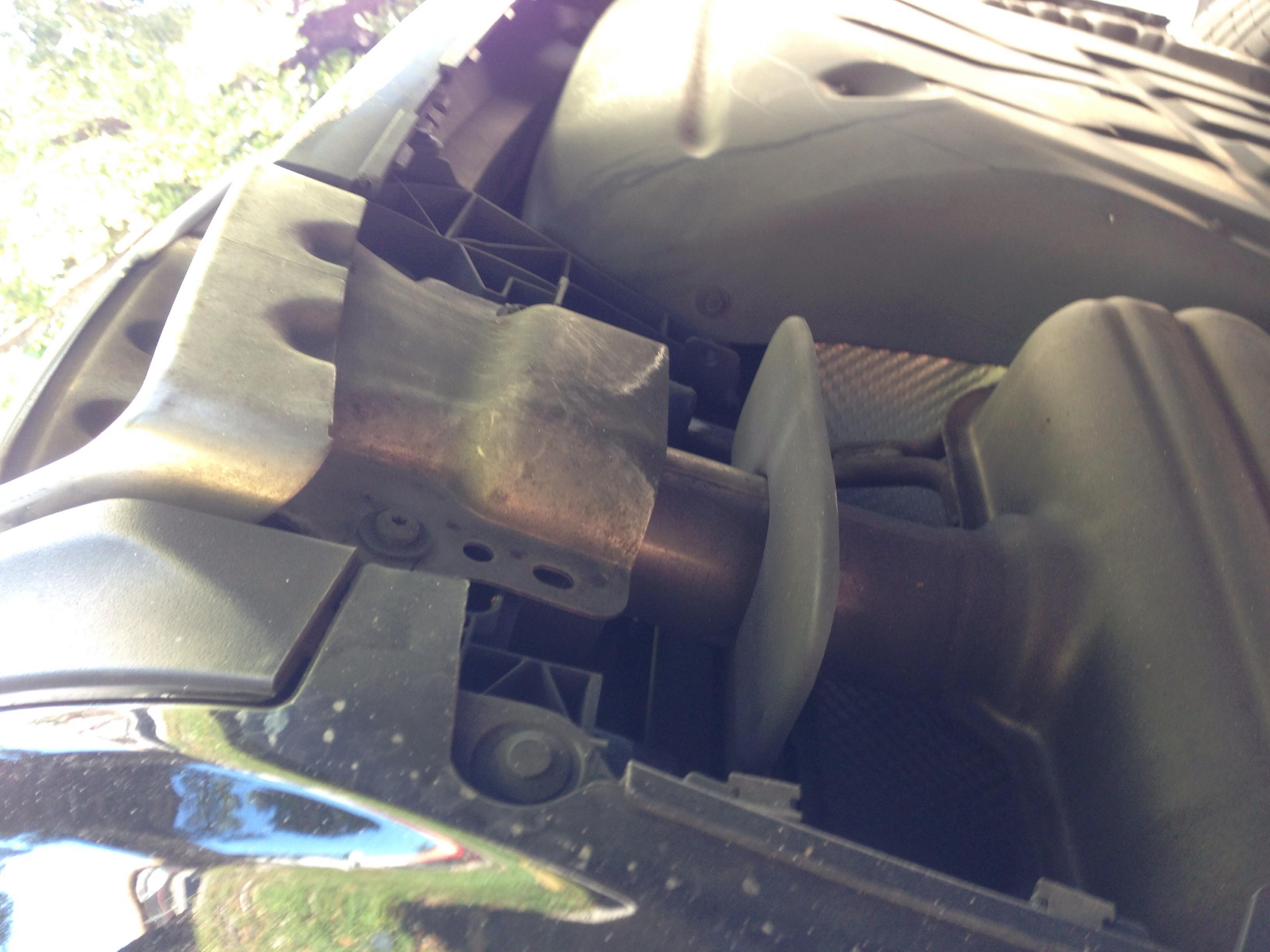

I just did the diffuser on my 2010 from base to S63/65. It required two pieces, a lower panel (what everyone refers to as the diffuser) and then a body colored finish panel that goes into the center. The diffuser and finish panel both snap into the bumper with plastic tabs, no tools required. Both parts were around $230. I also installed an aftermarket muffler and quad tip set up, but if you wanted to leave the stock mufflers and just do the square tips, those are on Ebay for around $285 (replicas).
I believe it's the same process on a 2007 but you'd want the lower panel and center panel for the 07-09. I used the EPC and a VIN from a 2010 S63 to verify the diffuser part numbers. I'll run an 07 S65 and post those part numbers.
The lower panel (the piece in the lower bumper with the exhaust cut outs) is available from Rock Auto for $109, their part # is MB1115101. The center filler is MB2218853225.
Should be a snap on part on a car that already has an AMG appearance package rear bumper. Just note that on the 2010, the exhaust tips aren't actually attached to the tail pipes. They attach to the rear bumper and the pipes sort of float inside. As a result, when you remove the tips, you're still left with the brackets, which have to be cut back so they don't peek out of the larger openings in the new diffuser.
The new tips (if you're just doing the cosmetic part) will need to be welded to the existing tailpipes.
Also, the diffuser has two mounting tabs on the bottom that secure the lower edge to the bumper. The new diffuser's tabs will not line up with the bumper's receiving slots. It took a little extra work to secure the lower edge.

The center filler comes unpainted. No color code. I painted mine silver this weekend with Krylon Universal.
That's the original bumper with just the lower panel (diffuser) swapped out plus the required center filler panel.
