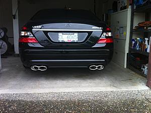

Rear diffuser $500 dealership
Full S65 AMG Exhaust $3000 Flying Tiger Development
http://www.flyingtiger.ca/history.php
Attached Thumbnails s65 diffuser for 07 s550-006.jpg   s65 diffuser for 07 s550-007.jpg

S550 AMG eh?
Old Oct 27, 2012 | 03:15 PM
titanle's Avatar
Joined: Sep 2009
Posts: 159
BMW X6 Activehybrid
Lol I wouldn't badge mine. I just like the big exhaust tips.
Old Oct 27, 2012 | 10:51 PM
xxGenericSNxx's Avatar
Joined: Sep 2008
Posts: 3,076
Likes: 28
From: Seattle, WA
99 ML430, 01 CLK55, 07 R63, 15 E63 Wagon
Oh I was just referring to those images. I LOVE how the 65 exhaust look on any MB.
