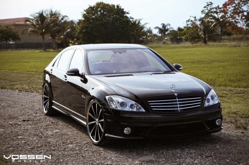

Thank you. We offer many styles for the W221, most go with 20s or 22s. Mercedes just posted about us on Facebook!
22s
20s

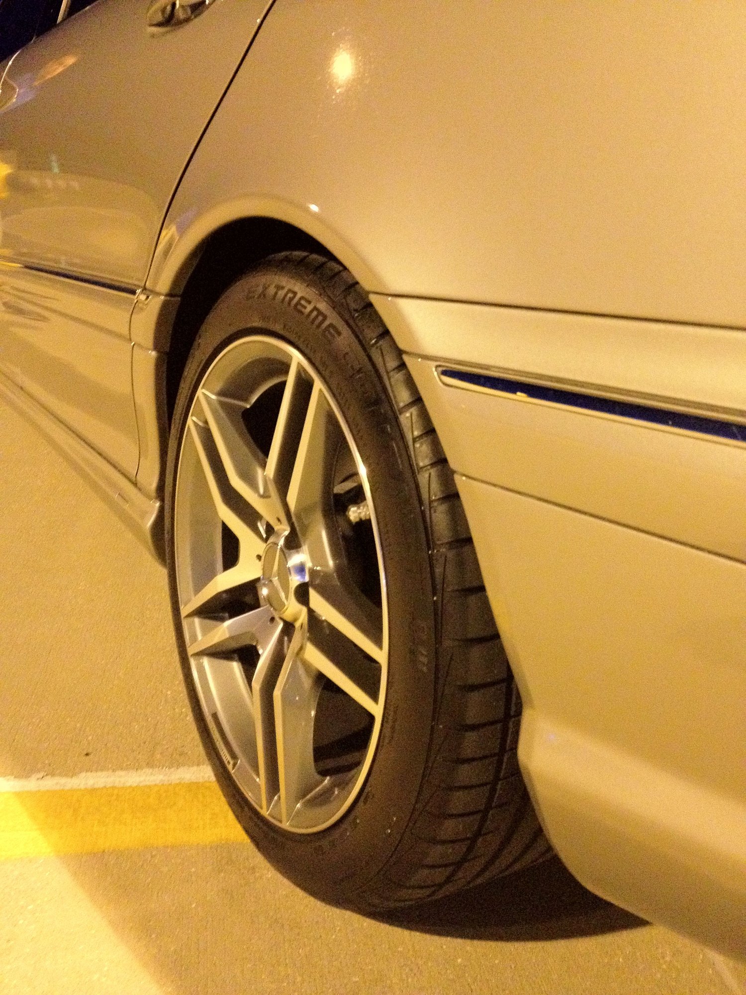

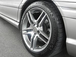

Vossen's are beautiful wheels. If the budget is smaller however consider a replica wheel. I've had a couple of sets and have been impressed with the quality, especially at the price. The last time I had tires mounted, they all took very little weight, and one took no weights at all. For $650 a set, if you curb 'em it's not heartbreaking. These are a direct fit with the correct offsets:
http://www.ebay.com/itm/300906356339?_trksid=p2055119.m1438.l2649&
ssPageName=STRK%3AMEBIDX%3AIT

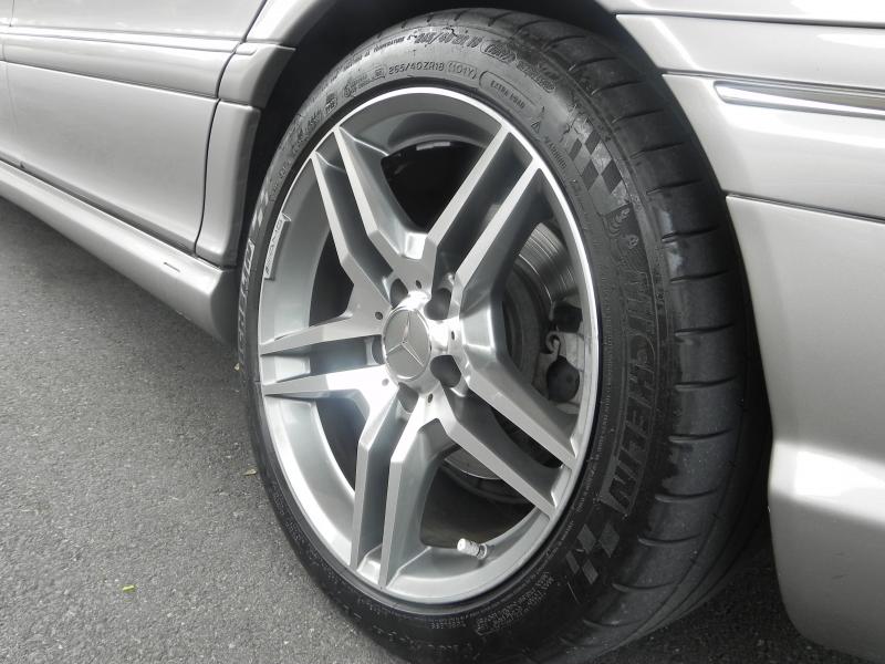

It doesn't show in the pics, but there's an AMG logo on the lip. Here's the wheel in an 18 on my prior S430. Remember to stick close to the factory offsets. Wheels for the 2008+ C Class, 2000-2006 W220 and CL will also fit.

That's pretty cool. Did you get these wheels for your current S550?

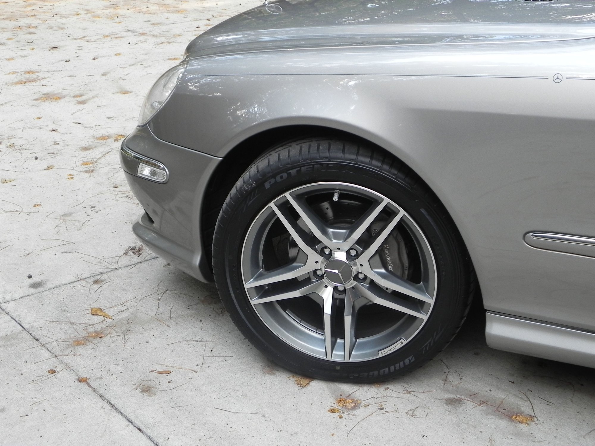

I know for sure the AMG cars (S63, S65) have big brakes. I believe the S600 does not. However, the 35mm ET will look better anyway, and that is a safe fitment big brakes or not.
Just remember this as far as understanding offset: Staying at the factory offset will position the new wheel in the wheel opening exactly where the old wheels sat.
Reducing the offset brings the wheels out further toward the fender lip. So a 35mm offset wheel on a car that takes a 45mm offset factory wheel sits 10mm closer to the fender lip (and 10mm away from the brakes).
Cars tend to have a more aggressive looking stance when the wheels aren't too tucked away toward the center of the car, so while the 221 takes a fairly high 43mm offset, switching to 35mm will bring the wheels out a little more. I'm running ridiculously low offsets...23mm rear (20mm further out than stock) and 28mm front (15mm further out) and the wheels sit flush with the fender lip. I couldn't go any lower on offset though without clearance issues. (I'm on stock ride height. If I were lowered I'd likely have clearance issues with those offsets.)

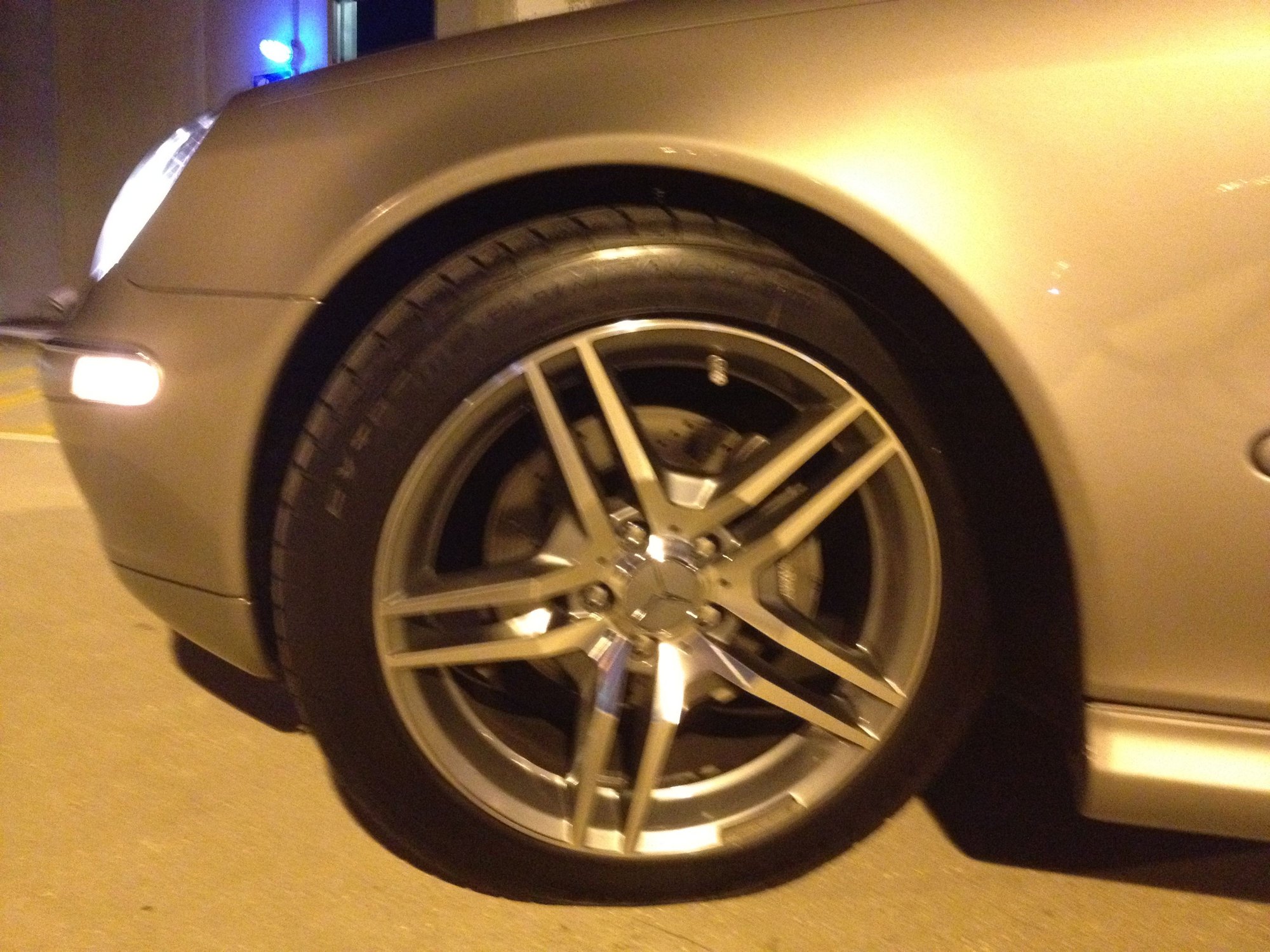

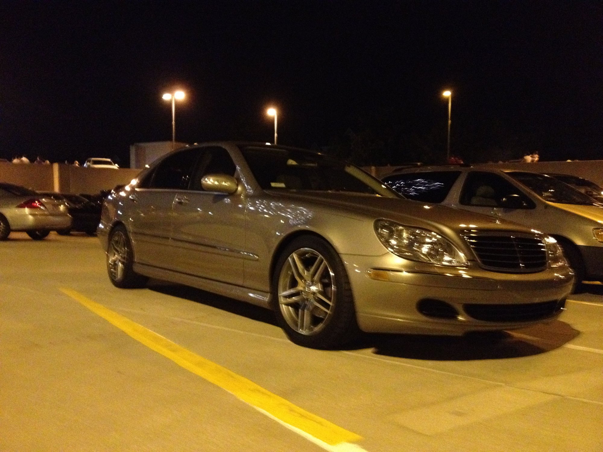

Here are more of my 18" on the 220. The 20's will look a good deal better (shorter tire sidewalls). These were 45mm offset wheels, but when the pics were taken I believe I had spacers on the car to lower the offset and the car was lowered as well.

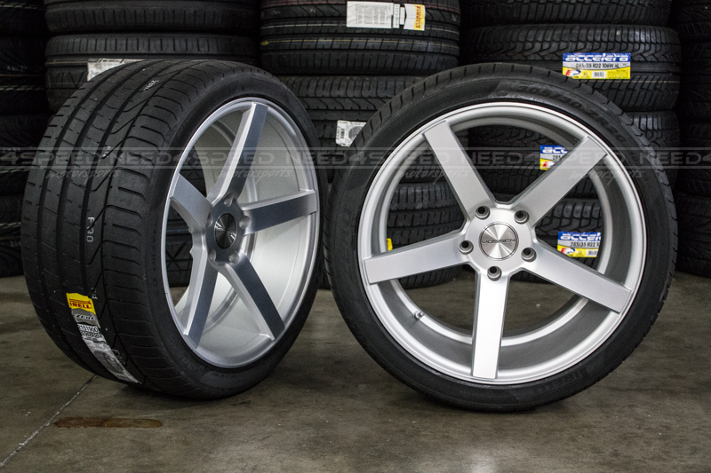

Niche Milans, available in S Class fitment 20" staggered or square.
http://www.carid.com/niche-wheels/mi...d-9801579.html
