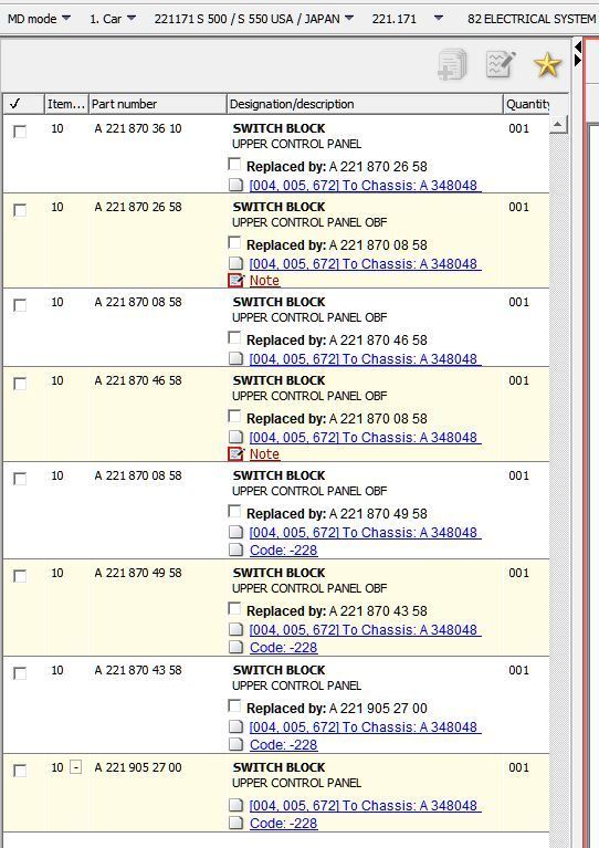

Control unit location in the picture.

Can anyone please provide instructions and DIY pics? The one pic was a bit confusing to me. Are these parts in the glove box or under the glove box?

What is the control module you are referring to? Do you have a part number? Are you referring to the blower fan regulator (221-870-67-58)?
Current part # 2219052700.
