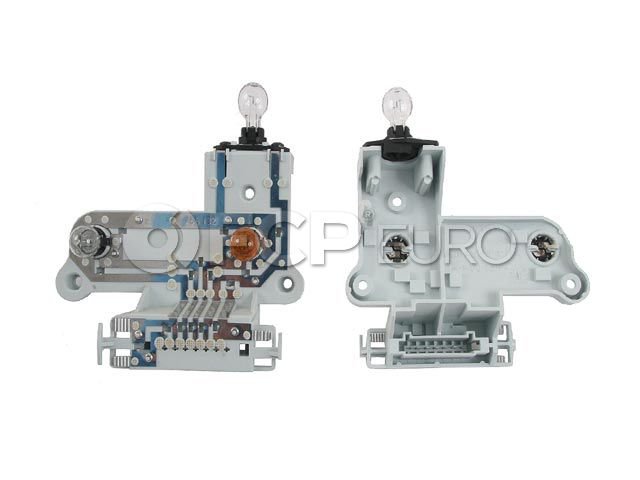

Thanks Kent, certainly trying to connect into Mercedes decision making circuitry/use Mercedes trailer controllers may be difficult. But looking at my pre-face lift W221 (2010 and newer may be different), the rear lights use light bulbs - the Tail Light Bulb Carrier - part #2218200277 (photo below) shows the paths from the connector to the bulbs - passive circuitry only. So it should be straightforward to just locate appropriate wires (brake, left and right indicators, marker light) and tap those to a generic trailer lights and brake controller. I've done it in another Mercedes and it worked fine. The only concern would be if it changes circuit resistance enough to trigger "failed bulb" error, but those can be corrected with a bit of fiddling (in a worst case by picking up the voltage without drawing current). What would be a problem with this approach?
