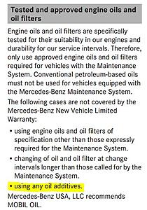

Hi Castro,
Per the Mercedes Manual regarding oil additives...Please read!
