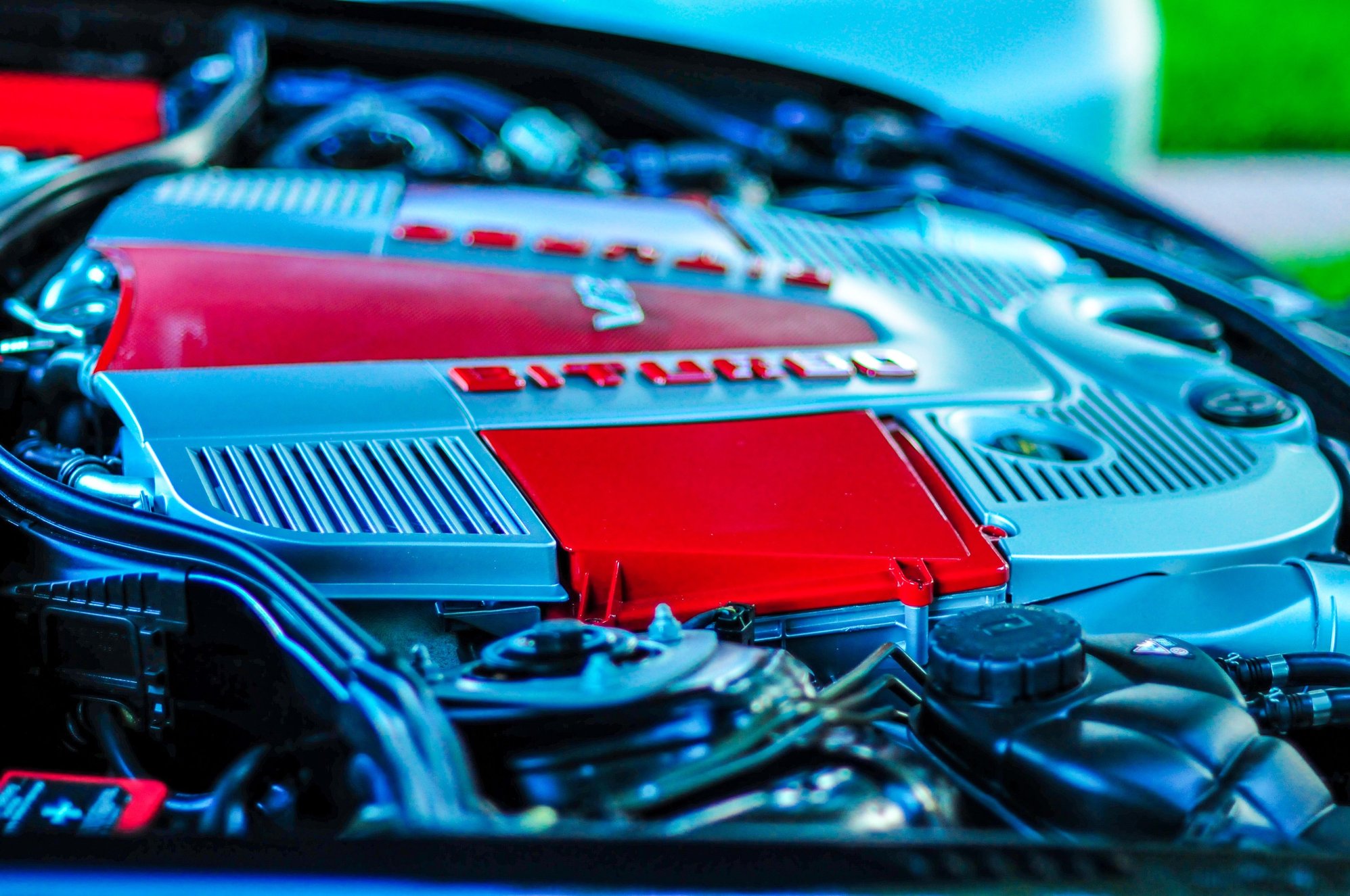

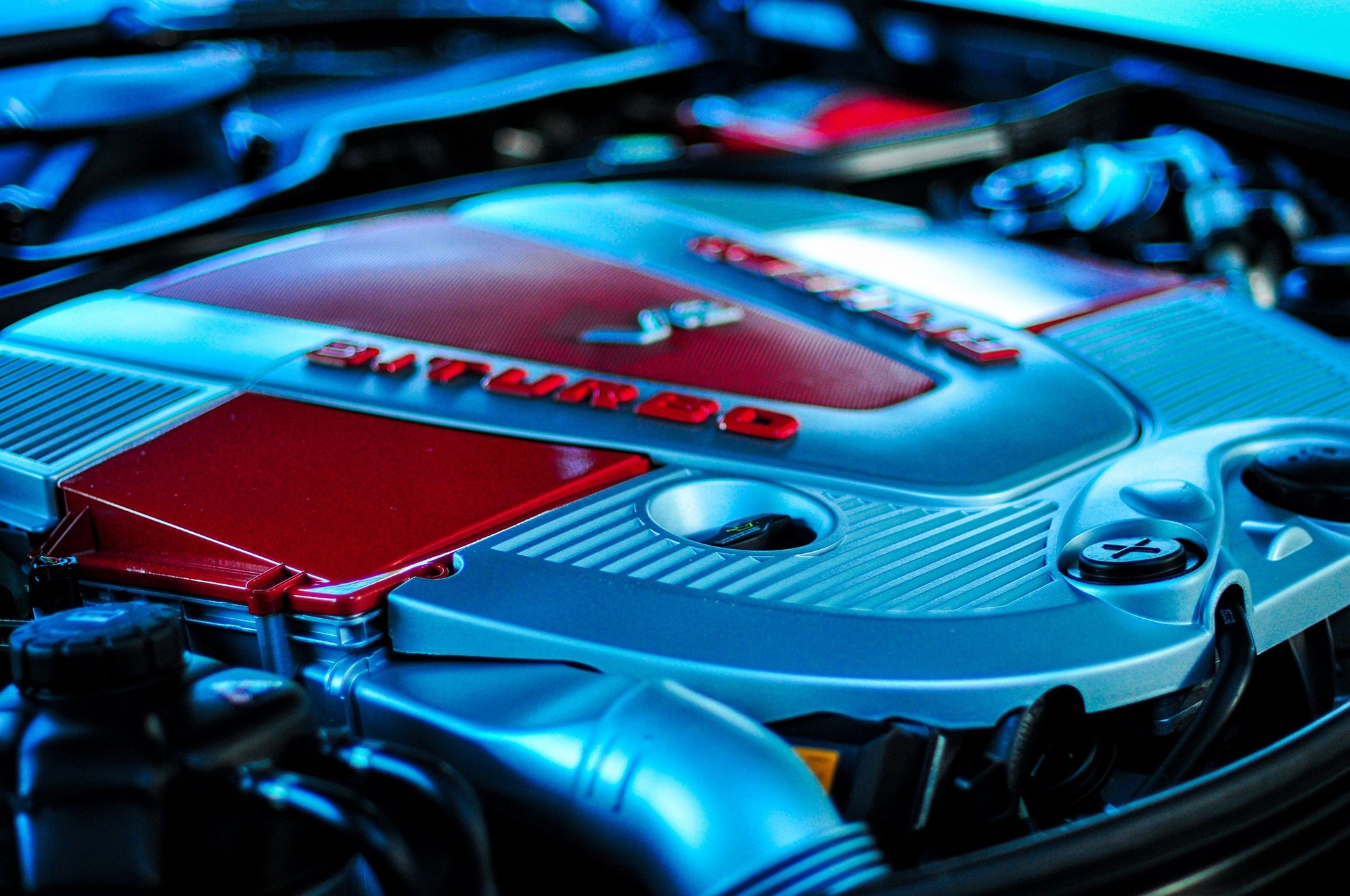

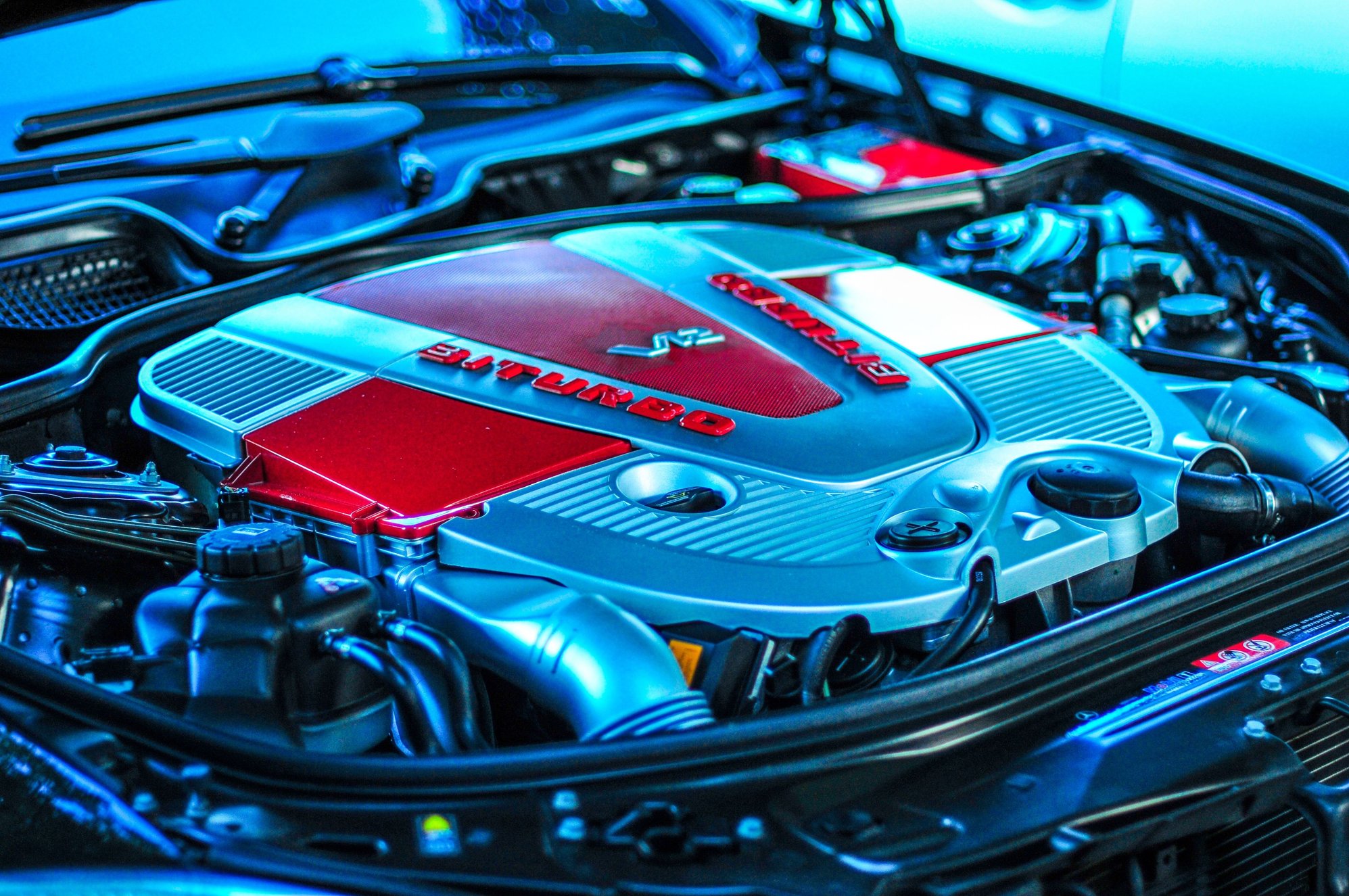

Last phase of the painting is almost done.
Old Jul 14, 2015 | 08:31 PM
  #70
WHPH28's Avatar
Joined: Nov 2014
Posts: 1,560
Likes: 207
From: Maryland
Depends on the weather

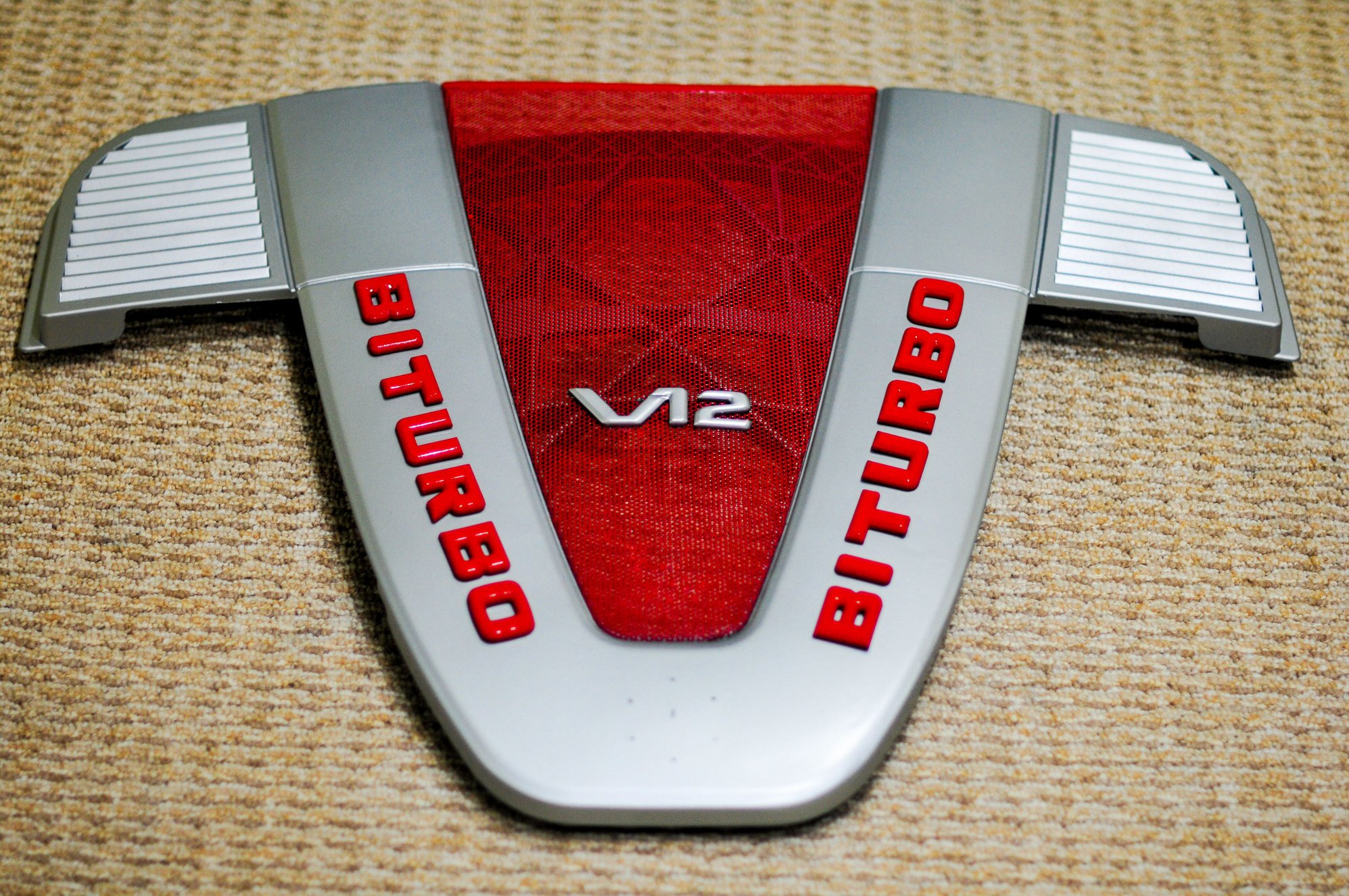

So, I put it on. I just need a new badge or something to go where that mercedes emblem was that is broken as they don't sell it separately, you have to buy the whole cover.
Some of you will like before (oem), some of you will like after. I think after gives life to the engine bay and isn't expected when you open the hood and it compliments the calipers nicely as a whole package.

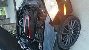

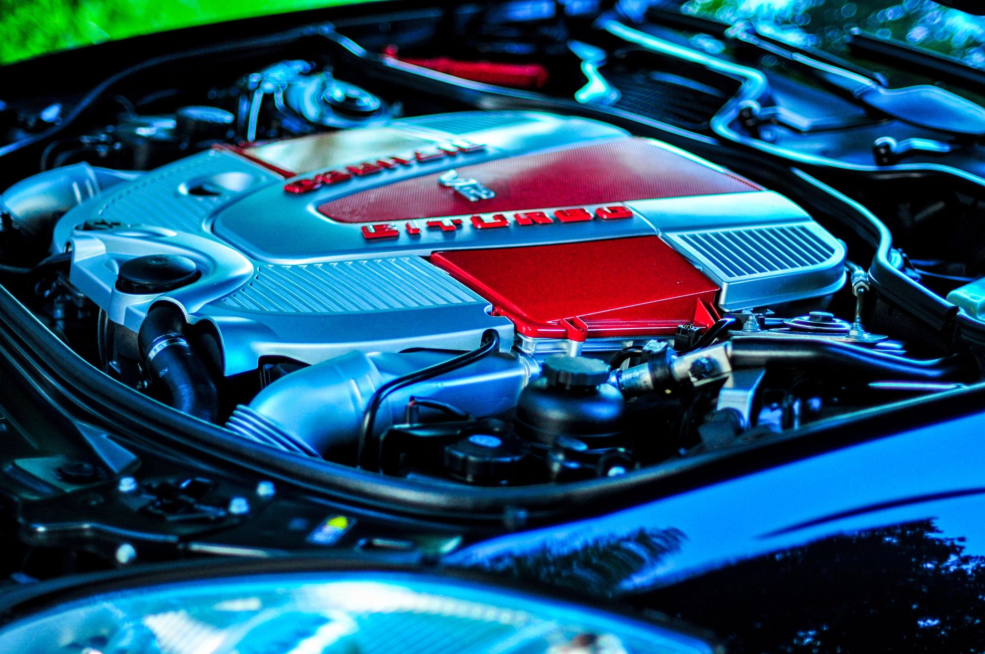

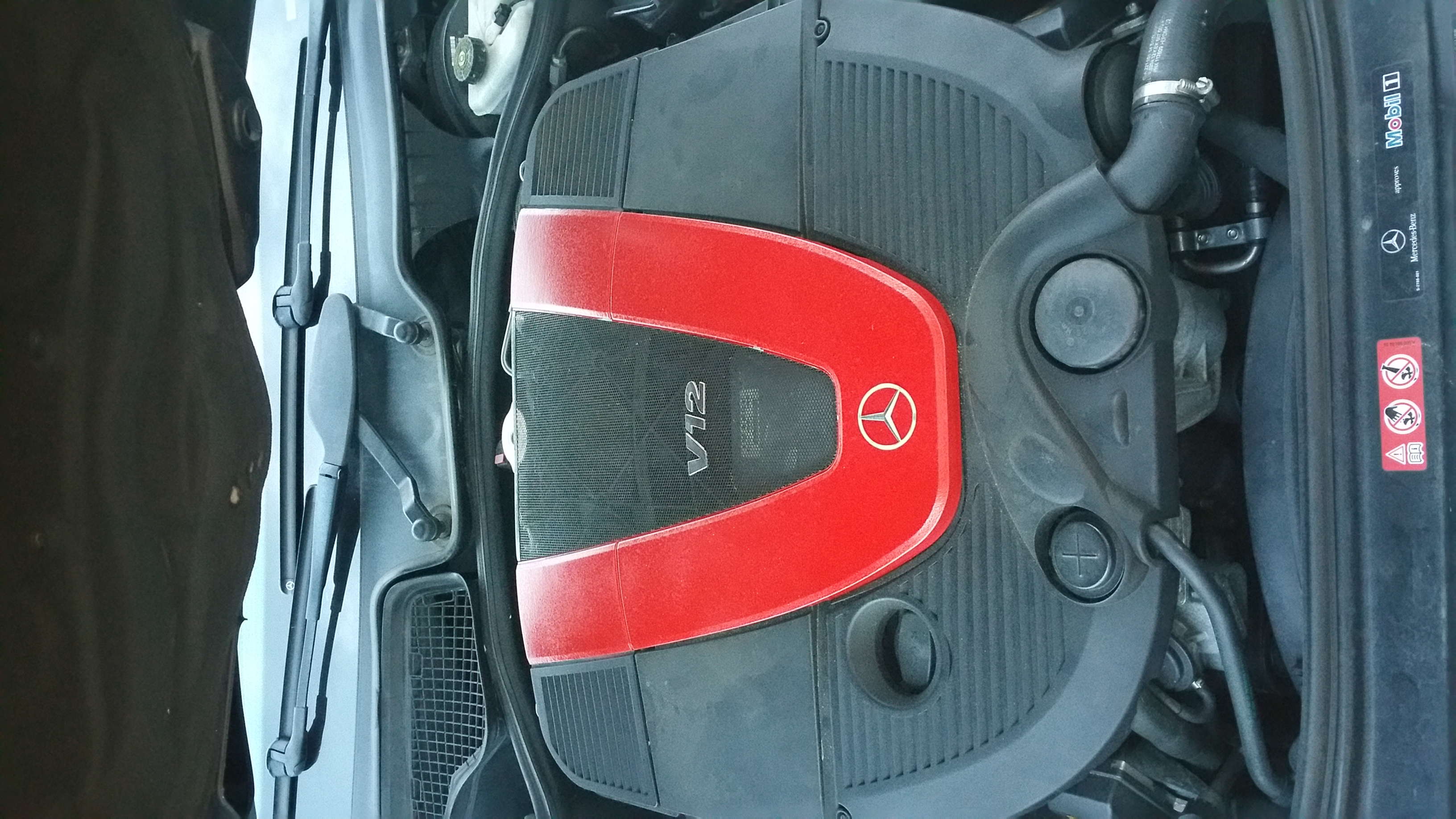

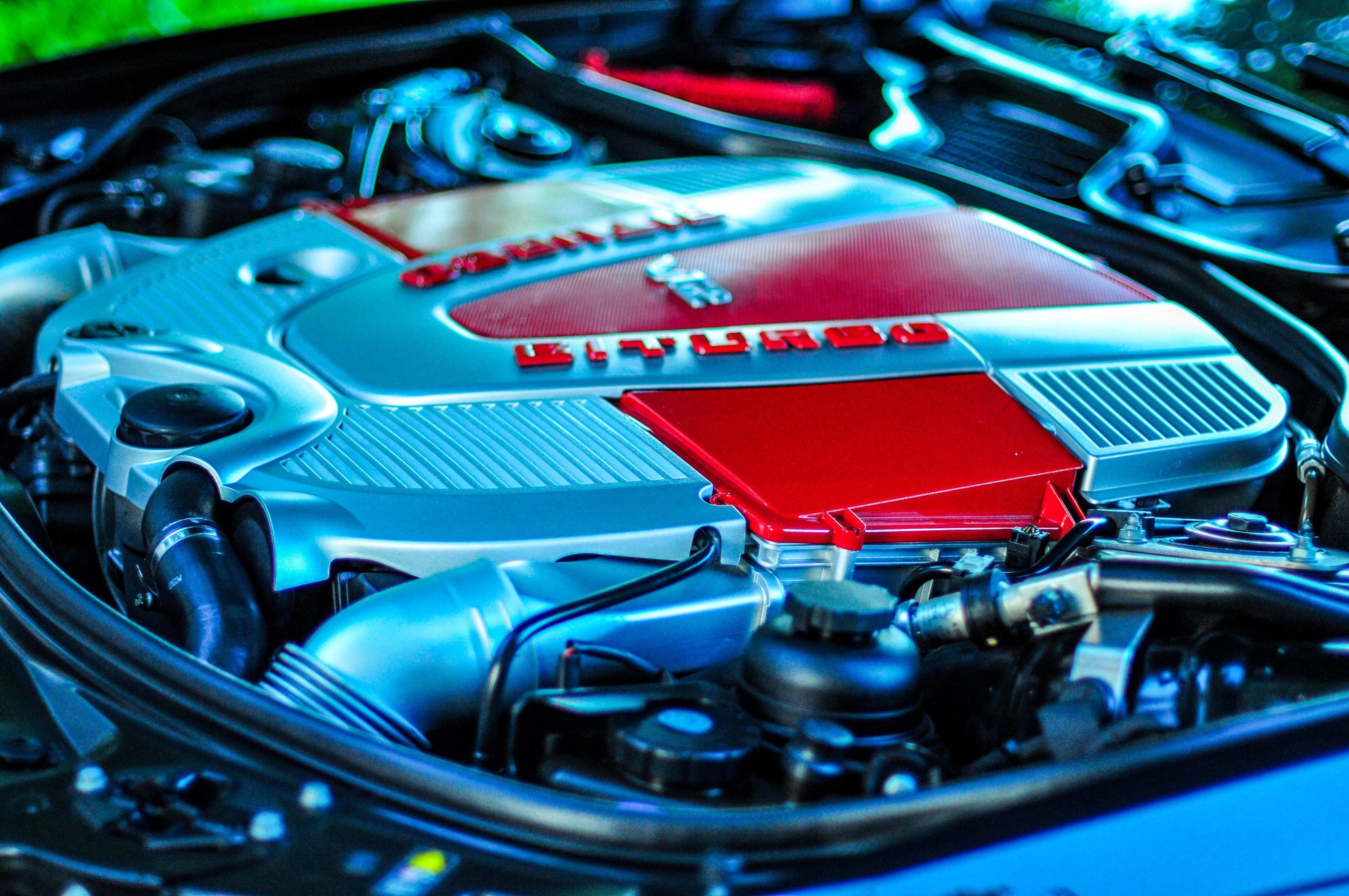

[QUOTE=WHPH28;6496902]So, I put it on. I just need a new badge or something to go where that mercedes emblem was that is broken as they don't sell it separately, you have to buy the whole cover.
That looks great! I went a different route and my engine bay also needs a good deep cleaning.. I'll get around to it..
Attached Thumbnails Intercoolers and turbos-20150714_201955.jpg   Intercoolers and turbos-20150714_201944.jpg

Holy dust. lol
