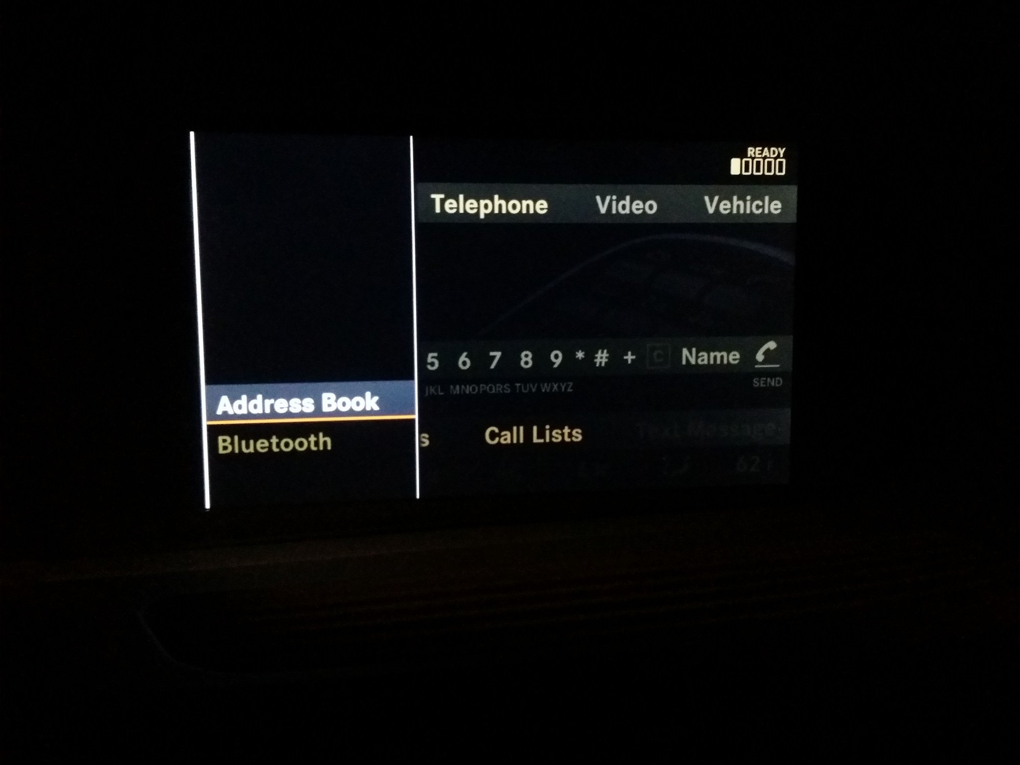

On my 2010 it shows up here:

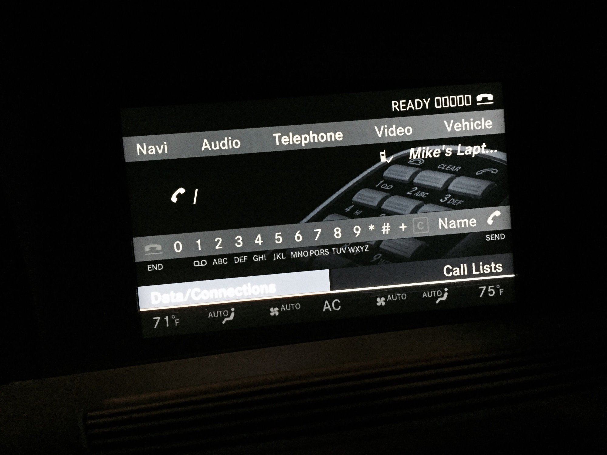

Does yours not have the Data/Connections tab in the pic?

Yes it does, it shows name but not addresses

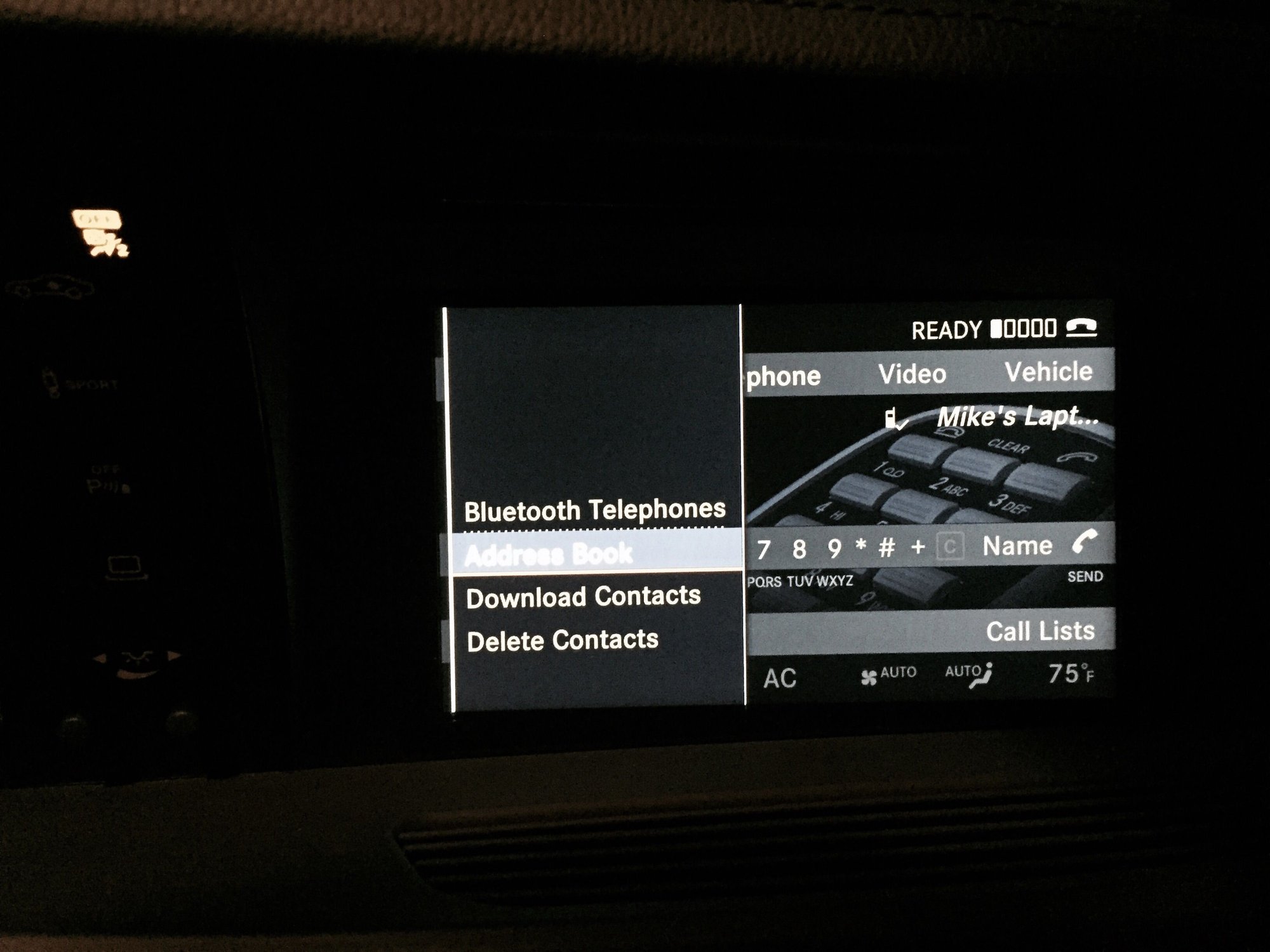

Yeah, mine will display the address fields of my contacts. I can select the address and it populates it into navi.
It's accessed via the data/connection tab, then "Address Book" from the sub menu.

It's not displaying address info for contacts that your phone shows have address info? The point of a sub directory called "Address Book" would seem to be for the function you're hoping for.
What happens when you click that link?
What kind of phone?

2010, but the fact yours has an "address book" function would seem to indicate your 07 will do the same. So when I click address book I get all of my phone contacts in a list.
If I select one, any info about that contact...address, email, website etc that's in the phone displays on COMAND.
If I scroll down to the address and select it using the COMAND knob, it switches to Navi with the address as a destination.
