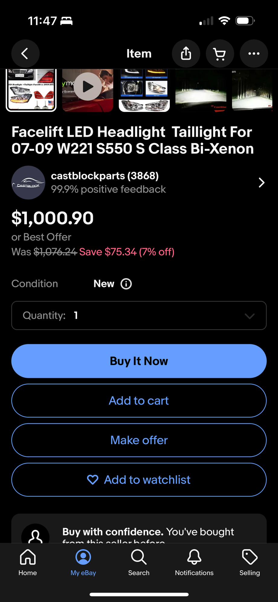

W221 s550
Originally Posted by mikieb
I bought facelift headlight, taillight combo off of eBay from a guy in Ca. It didn’t have night vision or curve illum, but that didn’t bother me, as I don’t have night vision on my 07 W221. I wanted easy if install and plug and play. I’m running Phillips 6k D1S and hella 100w in the high beams. Light pattern is great and I can see farther down road just with the low beams. I also upgraded the side view mirrors and front bumper too. All plug and play.
who was the seller in ca? Im interested too in plug n play
