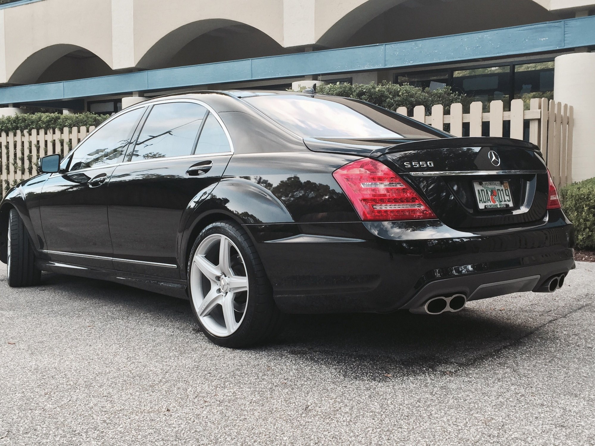

I have a 2010 S550. You're not going to like a muffler delete (the 2010 has two enormous mufflers and no resonators). It's absurdly loud. I did a Becker aftermarket quad exhaust and THAT was also obnoxiously loud. However, when we added a set of 18" glass pack resonators it was perfect.
There's a thread here about the Becker kit and I put pics and sound clips on there. Here's my car, stock AMG rear bumper with an S63 diffuser and the Becker kit. The Becker comes with the stainless ovoid tips. It's technically a dual exhaust since each quad tip shares a single exhaust outlet.
