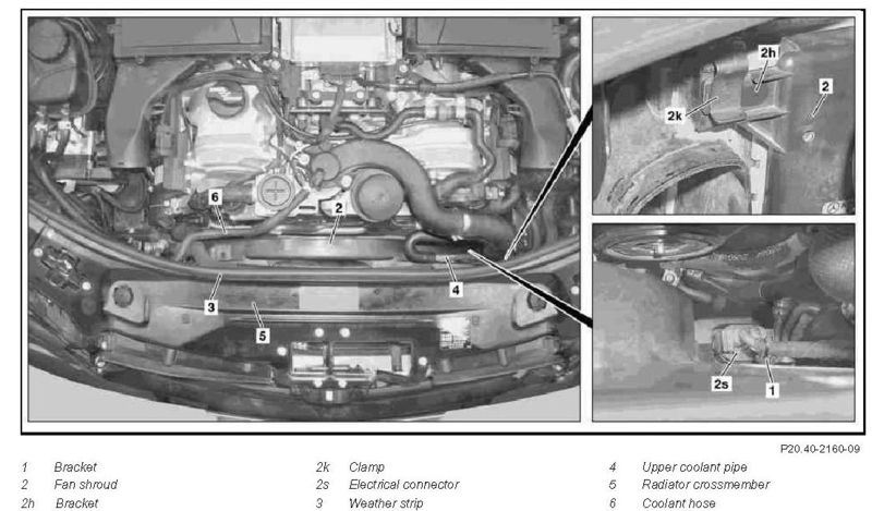

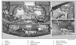

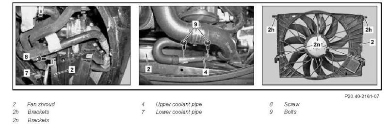

If you're referring to the radiator cooling fan:
