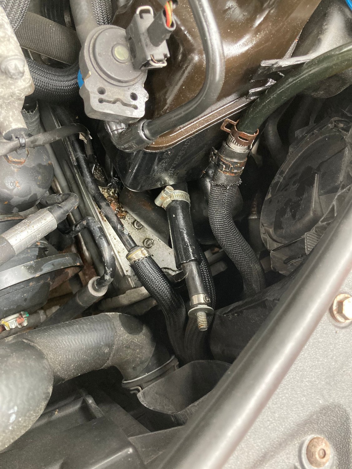

Old Apr 1, 2026 | 09:19 PM
Srslol's Avatar
Joined: Mar 2023
W211 W216 W212
Talking W221/C216
Visual representation how I done it.
Thanks to alx saved me from purchasing a tool
Simply lift power steering reservoir and remove the bracket held with 2x 10mm nut
and the ABC reservoir bracket 1x 10mm nut
12v oil pump was used for filling and suction fluid
Blanked off the return reservoir
It is a bit messy though.
