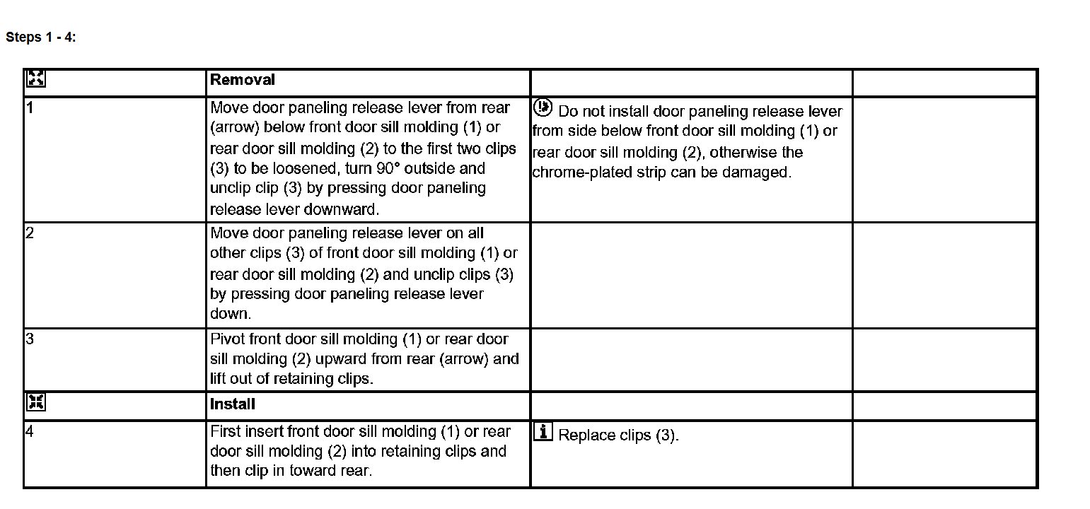

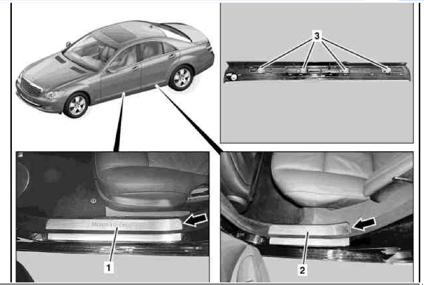

May have to start unclipping at the back:
