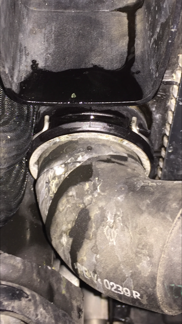

Old Apr 30, 2017 | 08:49 PM
604benz's Avatar
Joined: Jul 2007
Posts: 319
Likes: 16
From: Vancouver, BC
2015 S550V
This is where my coolant leak was at air intake of radiator
Old May 1, 2017 | 11:41 AM
alx's Avatar
alx
Joined: Dec 2004
Posts: 4,268
Likes: 253
thoroughly dry the area when engine is cold.
let the car reach operating temp and let it run for a few minutes more to make sure thermostat is fully open.
observe area of leakage. you should be able to see where it leaks from. for your setup radiator cracks are common in this area
