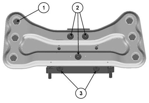

Any humming/droning noises, see attached bulletin.

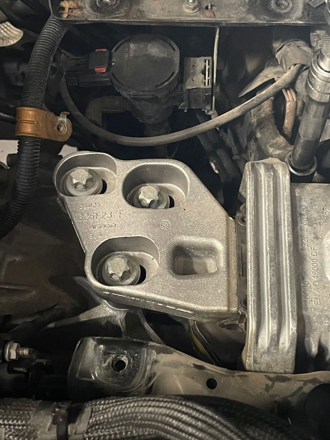

Hi, I had the problem with vibrations inside the cabin twice in less than a year.
I’ve got all the (3) engine + (1) transmission mounts changed. However they were changed at different time . So by the time they replaced the transmission mount probably the other ones were a bit affected already. Then replaced all of them. They explained to me they all are correlated so if you replace just one ,and you don’t replace the other probably that isn’t gonna fix the problem. On the other hand , when they finally replaced all of them, they noticed the previous shop installation wasn’t right . The transmission mount has some space in the screws area so it can be aligned. If the screwed are set to the left then the weight of the transmission will affect. It has to go right in the center of the screw hole.
Sorry my wording probably is not the most clear. I already spent 1400 USD in all this, I really want to help others avoiding this repeated issue.
see the image the screws or bolts to aligned to the left. That cause extra stress on the mount so it will fail again. Also affecting the other mounts.
