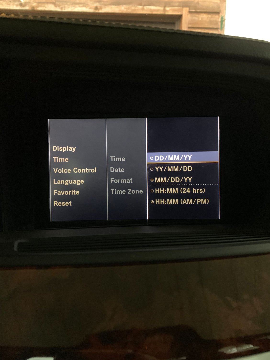

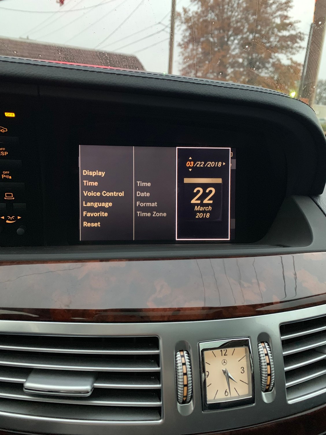

Hello all, I haven’t really posted much about my car lately, but I’ll have a first year of ownership experiences posted soon (y’all are right about running costs, but it’s so worth it.) Anyways, I’m encountering an odd glitch with COMAND and wonder if any of you are experiencing it. My car refuses to change the analogue clock’s time. No matter what I do with COMAND it doesn’t change. This wouldn’t be an issue, but daylight savings time just ended and I wanted to revert it back. Also, the car will not change the date. It’s stuck at March 22, 2018. No matter what I try to change (date and time format, MMD:YY) etc. it still doesn’t do anything. I changed the car to 24 hour time on my way home this morning and now the car won’t change from that. It’s very strange. Not a big deal, but it’s very annoying. My car has had it’s COMAND updated previously (it has birds eye view and the video option in the top ribbon) if that matters at all. I’m hoping if I reset the system using the option in settings it might work. Anyways, please chip in thoughts or experiences, have a great day!

Whelp, the car fixed itself. I decided to go and try it again after writing this post and the car’s date was correct (November 4, 2018) and the time was off by one hour. I changed the time and alas the analog clock changed. Ah, the quirks of owner a decade old computer on wheels. Anyways, thanks for reading.

So I took my car out today and low and behold the date has switched back. Luckily the time has stayed the same. I’m not gonna mess with it anymore until spring. Just think the debacle is funny.
