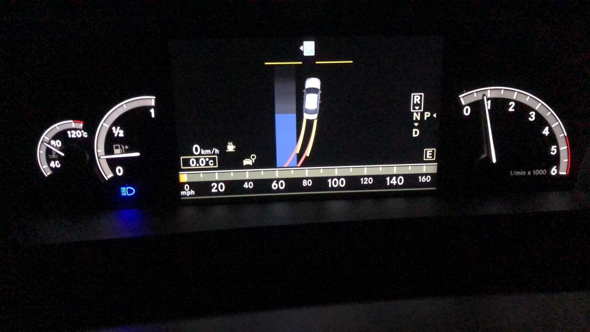

ive done a reverse last night and for first time in 1 year it appeared this thing. Can some one tell me what is it and how it activates please ?
Thank you

this is parking assist. It activates every time you see the blue P in the center of the Speedo, when traveling up to 22 mph. While the blue P is visible it scans the sides for a parking space long enough to fit your car. If you stop next to one then it guides to park in it.

Lol, that's the Park assist package you have there you lucky dog (see that blue P icon). Were you driving slowly looking for a parking slot before going into reverse? I bet you did because that's how Park assist is used/engaged.
The car has radar sensors that calculate if you will fit between 2 cars while slowly driving looking for parking. If it finds one, the P lights up and you should stop and go in reverse to park using the guidelines.

Mine is a 2013 and there is blue P icon comes and goes. Is it safe to say I have the parking assist? Then next the question goes how to activate it?

with CODE (230) Advanced Parking Guidance
(as of model year 2010)
If you engage reverse while the blue P> is visible just slightly ahead of the spot you wish to parallel park, you will see a message displayed. Before you let off the brake press "OK" on the steering wheel control, and you will see the guidance screen shown. Turn the steering wheel so the guidance and trajectory lines line up and beginning backing up. The system may guide you through several forward and back maneuvers before declaring the sequence end.
From experience, the parking spot you choose must have a vehicle in front and in back (a true parallel park situation) , and the system will only attempt to guide you if there's enough room to moor your boat in to the space.
By default, the system will only detect parking spaces on the passenger side of the vehicle. To use the system to detect parking spaces also on the driver's side, the turn signal that is indicating on the driver's side must also be actuated.

looks like the magic is to press the ok that I've been missing. Appreciate the education. Kind of excited to find new features after more than a year of ownership.
