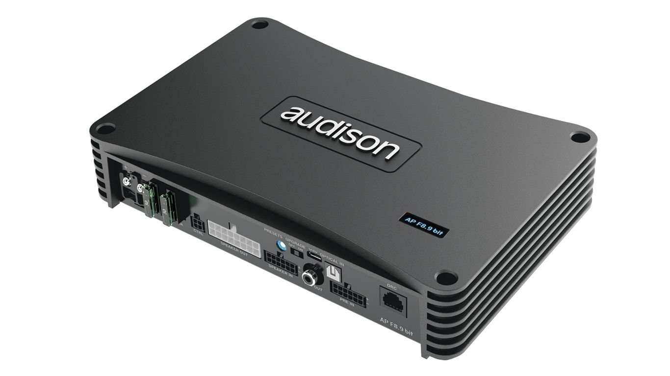

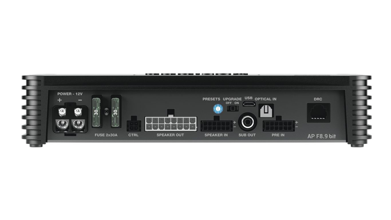

the issue is threefold
1) the std amp is locked in as part of the car - its not 'just an amp'
2) the stock amp dies all the time - and is hideously expensive
3) its an under powered bit of junk that sounds horrible
forget messing with subs or speakers - as with ANY decent upgrade - good clean power is ALWAYS the starting point - until you fit an a high quality powerful solution for the speaker driving part of things its all a waste of time
thus because of the Merc install you need to take high level noise off that stock amp (or know a hi fi electronics guru to add pre-outs to your Merc amp) and push it into something worth bothering with like
https://audison.com/product/ap-f8-9-bit/
