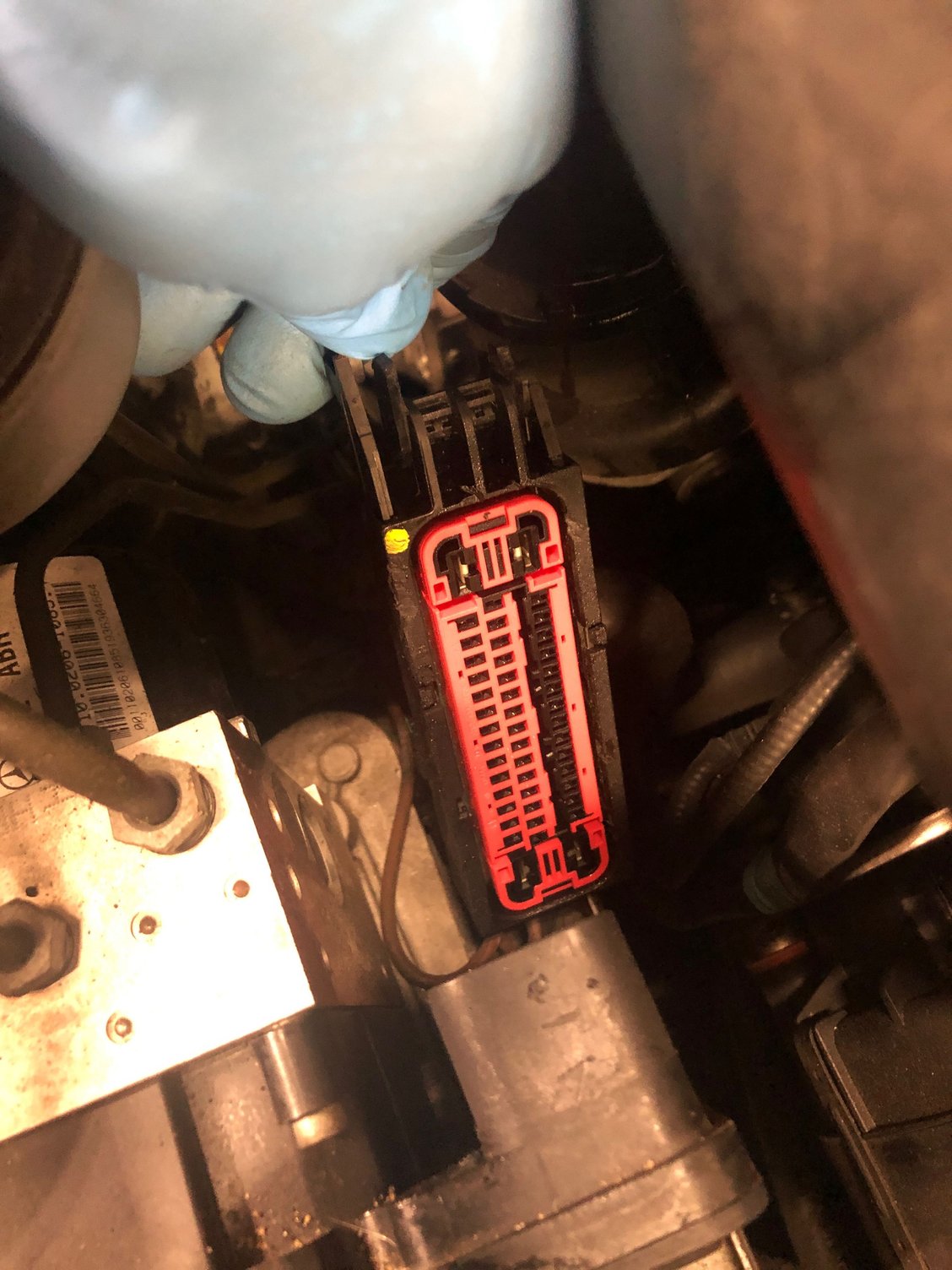

I cleaned and reseated the ground strap.
I removed the massive "plug" and sprayed both it and there it goes with electrical contact cleaner
I reseated the plug
Error persists.
But... here's something odd. I ran a voltmeter to what I assume are the power inputs (two, thick red wires) at the top of the harness.
With the engine running, the one on the pass side gives 14v (good!). The one on the driver side is 0v (bad???). Anyone know if these are indeed power wires both? If these should both be supplying power, then this jives with the code I saw of "under voltage" for the module itself, right?

Without a wiring diagram (and probably more knowledge than that), it's a guessing game. You may see different results depending on whether the ignition is on or off, engine running or not, etc.

I tweaked my post. All results were with the engine running. Hoping someone on here has a wiring diagram!
