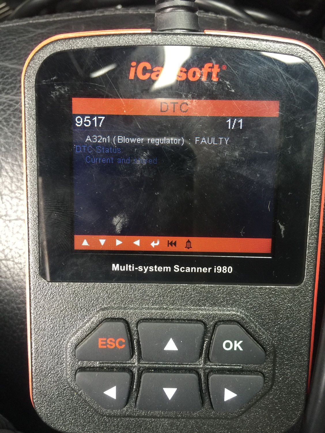

So I will start off by staying that my car hasn’t 157k miles . I noticed that on the front passenger seat under the dashboard that there was water dripping. Well of course the front drain was clogged . I cleaned out the drain and order a new blow motor. I also decided to ordered a new resistor as well. Well I get both parts and install them and nothing happens. I get an dtc codes. I attached the pictures of what of the codes I get. One of them is with the old resistor connected and one with the new resistor both were connected to the new blower motor any ides?

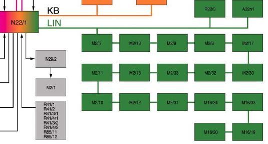

Check f50 & f54 @ front SAM (engine compartment). Components that communicate with each other over the LIN bus are connected in series. Limp mode can be actuated if the blower regulator detects a disruption in communications. If the ground connection has malfunctioned or there is a short circuit in a LIN bus component. Refer to the block diagram. Correct blower regulator is part 2218706758, motor 2218202714 - purchased used always the chance could be defective.

To answer the first question. I used brand new parts. I bought a brand new blower motor hella behr and I bought a behr resistor as well.
kon,
your the man thank you very much . It was F54 that was blown. From the naked eye it didn’t seem blown but it was ! Thank you again . I replaced the blown fuse and all is good.
