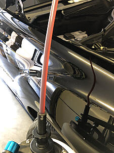

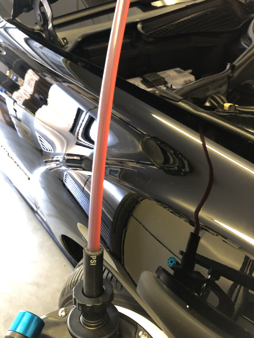

So I decided to take a look at the transmission fluid via the dipstick. To my surprise, it's brown from a service just 2000 miles ago. Going to do the transmission fluid exchange with suctioning... Remove and refill with the same amount of fluid.

Old Jul 20, 2020 | 01:01 PM
2007sclass's Avatar
Joined: Oct 2018
Posts: 190
Likes: 13
From: North Florida
S550
was the service just a drain and fill?
Old Jul 20, 2020 | 07:57 PM
DrDoe's Avatar
Joined: Jun 2016
Posts: 589
Likes: 60
From: Snowville, ID
W212 E350; W166 GLC300; W164 ML550; W164 ML63; W221 S65; W220 S430; Escalade ESV
The service notes said fluid and filter changed so I believe only 4.5liter got removed.
I was able to remove 4.0liter so I guess I'll be doing it again after the next 2000 miles.
Old Jul 20, 2020 | 11:38 PM
2007sclass's Avatar
Joined: Oct 2018
Posts: 190
Likes: 13
From: North Florida
S550

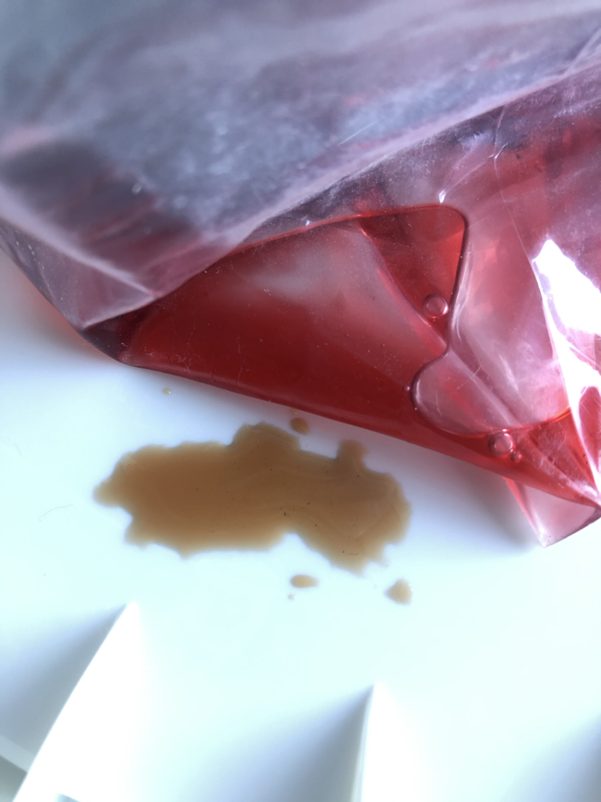

Update: Decided to remove and refill transmission fluid after 1000miles. This time the fluid was hot and I was able to removed 4.5liter. The fluid color looks good this time around so I believe you just need to do one extra fluid exchange after the standard fluid and filter change.
A better idea would be to perform the fluid exchange then drop off the car for fluid and filter service if you don't want to mess with guessing the fluid amount and the temperature.Where to get W221 S600 722.6 transmission rebuild?-photo949.jpg
