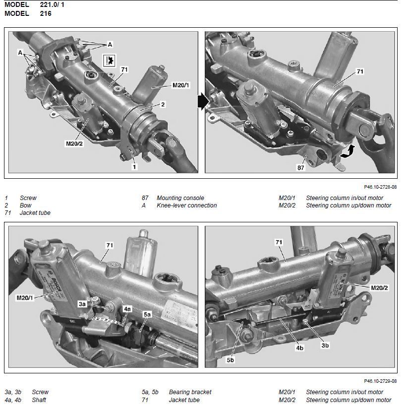

Someone might suggest a temp/simple remedy however, for permanent solution need to check motor (m20/2) & shaft (4b).

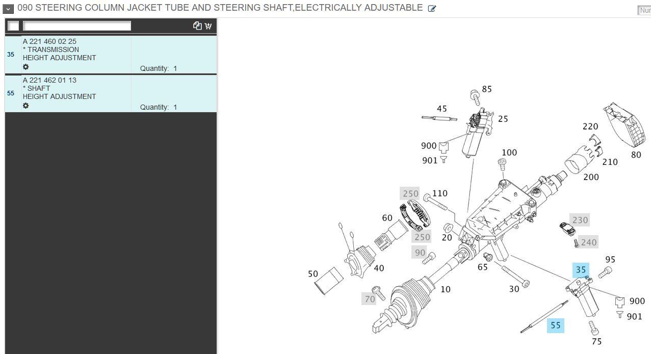

I'm always about the permanent solution.
Is there anyway to get the part number for both of these?
Thanks!
Old Jan 7, 2020 | 11:14 AM
konigstiger's Avatar
Posts: 15,901
Likes: 4,632
From: North Scottsdale, AZ
'71 Pinto

See attachments.
File Type: pdf

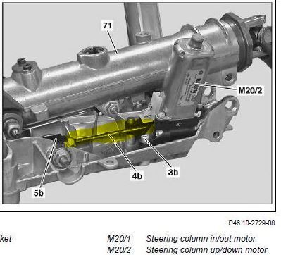

It's been awhile but I finally had time to look at the problem. I took the panel out from the foot well and after twisting myself in this very tight uncomfortable space was able to see both column mover motors. The non-functioning up/down movement motor is the one on the left side. As the motors are in hanging down position I took the up/down motor out and it works fine. I put the motor in place without the two screws and it kicks the motor out when I hit the up switch. I have to hold it in very strongly to keep it in place during this test so I believe the motor is good.
It obviously is that the movement mechanism has locked in place when someone ran the down movement all the way down. The
The motor has a worm gear on so I tried to push down on the gear wheel inside the round hole that the worm gear goes in but I could not make it move. I'm not sure I was pressing at right part. It felt little soft so thinking if it is plastic it could break if pressed too hard so I stopped.
So, it seems removing the steering column is the job to do now to get to it. I have learned that this issue is quite common with these cars so even a new steering column could have the problem very quickly so if I remove it I.m quite sure a mechanical stop can be added to it so that it cannot run in the end to get jammed like it does.
konigstiger posted instructions about the column but there are several other parts that need to come out around the cluster first. Any instructions for that part?
But, the good info from all this is that if it is a motor problem the motor can be changed out thru the foot well without removing the column.

No problem, take a picture of underneath when you take the cover out from under the steering wheel, and I will point you to the right area. I think you might have to take the wood trim out too.
One thing, make sure you do hear a very tiny click noise when you try to adjust the steering column, this means exactly that the motor is working just not strong enough to make the column to move
The type of gear that you are looking for is a "WORM Gear" basically its long and attached to the motor, and it simply went too far, and it just needs a little "push" twist in the right direction, plus some lube so it won't do it again.
You can either grap the end of it with pliers, or there might be so other way. Just do not take the thing apart,
If you like, we can do a video chat. send me a private message
